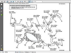

Old Apr 22, 2010 | 06:47 PM
cfdfireman1's Avatar
Joined: Oct 2005
Posts: 4,165
From: Chicago
try again
you checked all of these clamps? do a boost leak test my friend. classic hose off
