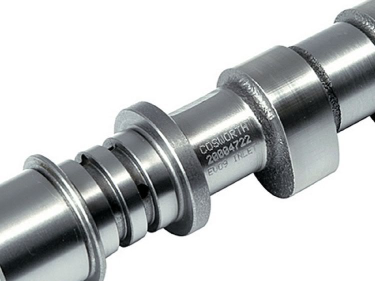

Did some research and came up with this picture the numbers are different but the Cosworth looks identical, im going to pull the vavle cover and check things out soon, ill let you know what i come up with.

Ok so i pulled the valve cover today and they are Cosworth M2 cams..... numbers on them are 20004164 inlet and 20004166 exhaust.
