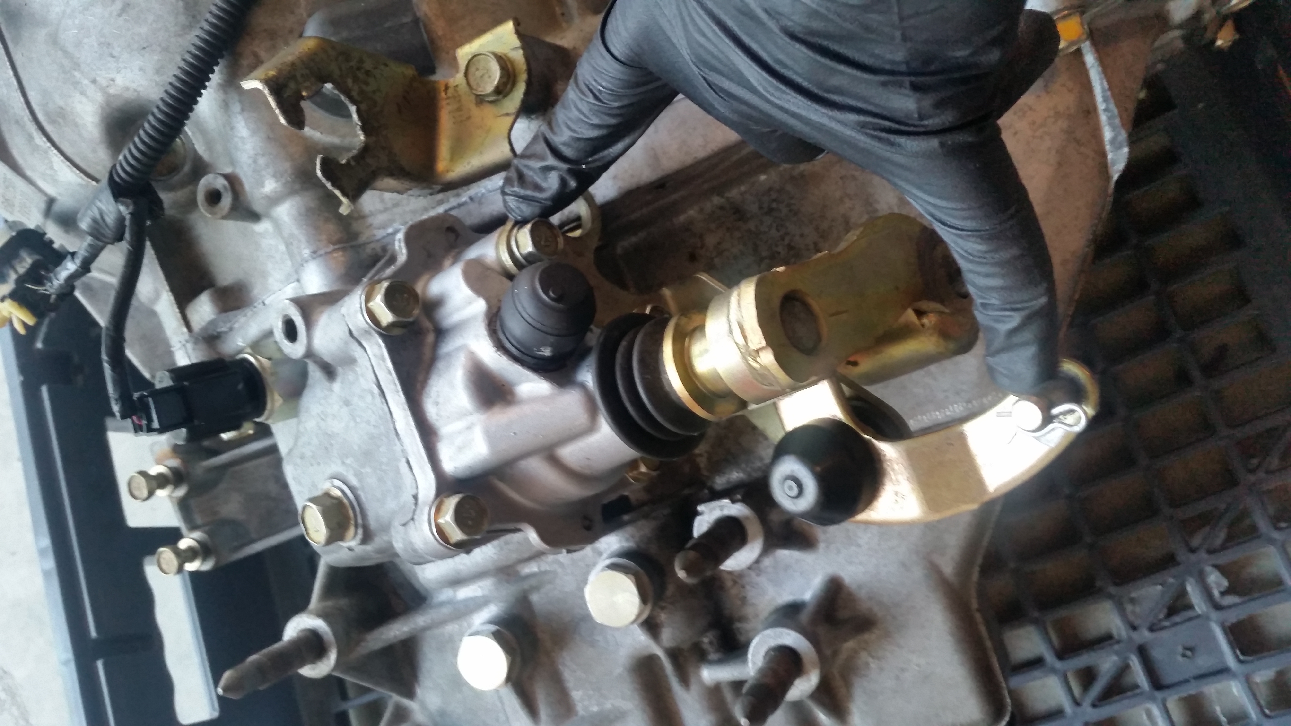

So it has come time to start fixing my Evo up FINALLY
I've been looking around and found a few threads about the same problem i've been having but still cannot fix it.
SO the problem im having is my shifter in the cabin is being VERY SLOPPY.
As in you place it in 1,2,3,4,5 gear and you can move it all over the place while its in gear.
Also, its hard to get it into 1st 2nd 5th or reverse because there is so much play in the shifter.
NOW, ive checked the in cabin bushings, the shifter cables and nothing.
Went ahead and replace both the shifter bushings in the cabin AND under the hood.
I think i've found the problem with the actual shifter fork on the transmission. It's the bracket that connects from the transmission to the shifter cables.
I need help finding the parts number or maybe if someone has replaced this part? If they can share some input?
I attached a picture i found of it on the web lol
Its the whole bracket the guy is pointing at with his hand from pointer finger to pinky

http://www.streettunedmotorsports.co...d_md746246.htm
http://www.streettunedmotorsports.co...d_md745788.htm
It's 2 separate parts ain't it? It looks like one bracket.
Why do you think it's your problem anyway?

Noticed it was missing the rubber cover on it. When I started playing with it I noticed it had a lot of play in it and the one time it somehow locked up my shifter started working

Let it be known!!! Another cause of sloppy shifter/locking out of gears is due to part MD771824
Issue solved!
Issue solved!
Issue solved!
Is that the little half moon plastic piece?

Just FYI this part also comes on the Dodge Ram, Chrysler Sebring and the Dodge Stratus
If youre in a bind and as cheap as i am lol NOT GOING TO PAY $10 bucks shipping for a $7 part.... You can hit up the junk yard and just nab one
Indeed it is! Read my above post

Didnt read it but Im familiar with it all manual mitsubishis use those

Yeah, I was sitting here trying to figure out what goes wrong with a bracket. You may lift the entire transmission using the bracket and no harm. But, yeah, you need the plastic thingy.
