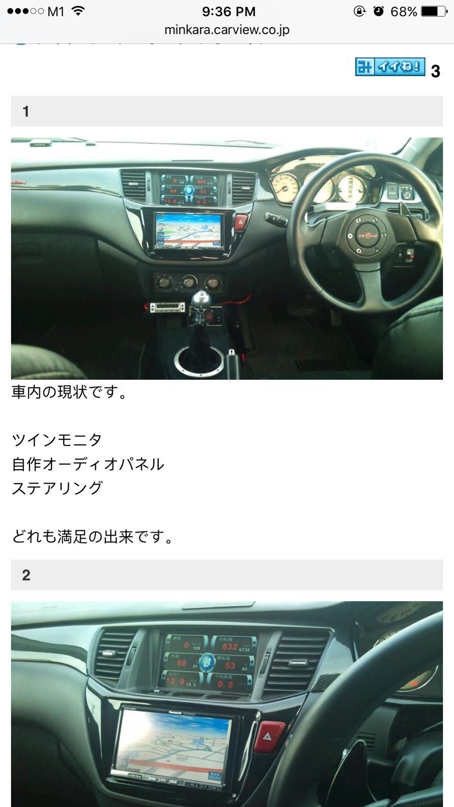

This must be that automatic Evo 7? Spotted those paddle shifters
Old Dec 1, 2017 | 08:05 PM
cleong's Avatar
Joined: Sep 2015
Posts: 142
Likes: 33
From: Singapore
The other giveaways are the instrument cluster with the gear indicator, as well as only two pedals. It could either be a Evo 7 GTA or an Evo 9 wagon.
The owner has probably done extensive re-wiring when he swapped from the stock steering wheel to this aftermarket wheel with paddle shifters.
The centre console has also been swapped to a manual Evo's so you can't really tell its an auto gear stick.
This satnav was available as a factory option, but has to be built-to-order, as the a/c trunking is different, and you'd lose the centre dash clock, along with hazard light button relocate.
Just waiting on a couple more trim pieces and the work can begin.
