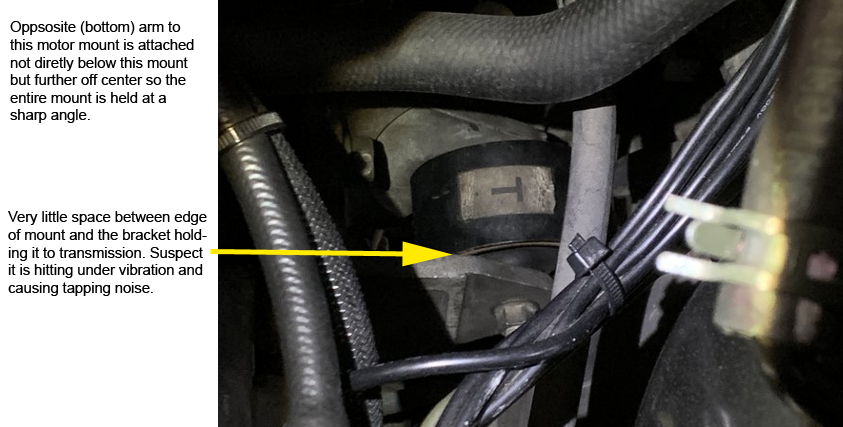

Is this motor mount attached right?
I had my clutch replaced a little over a month ago and was diagnosing a metal clinking engine noise recently and came across the rear motor mount (not under battery but next to firewall). I get the impression that this is not right. My rear mount sets at a sharp angle instead of coming off perpendicular to the bolt that connects it to the mount attached to the trans. I'm struggling to find pics online to confirm what it should look like and I'm confused as to how a shop could have installed it wrong which would cause this angle. Is this normal or should this mount look like the others and the bolt that runs through it should be perpendicular to the mount bushing....thus the arm that comes off this motor mount points straight down and not at an angle? I am wondering if the mounting bracket was installed upside down which might shift this motor mount off center. This is an 2005 - 5 speed. Anyone willing to take a pic of your rear motor mount and this bracket to confirm this for me?
Thanks!

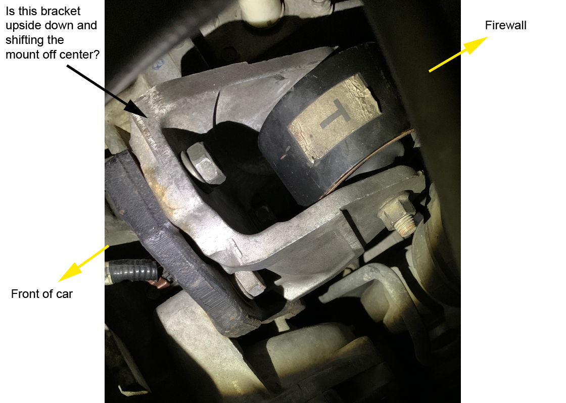

Seen from top side. Is this bracket upside down?
Is this normal?

I didn't think it was possible, but yes, that mounting bracket is probably upside down. The shop that did the clutch... Do they normally work on evos?
See 19:50 in this video.

yea..that appears to be upside down.

Thanks folks. That video confirmed my suspicion. I also went through the 05 service manual and it looks just like the video. That notch I see on the top right should be on the bottom left. Ugh
The only other clutch I had replaced was 10 years ago and I guess that shop could have done this also. I think I will just talk to the owner and see if he will be straight with me about what they removed.
I guess I need to go buy some motor mounts as I don't trust that back one anymore. I haven't replaced mine since owning the car but I only have 95k on it. I read somewhere that the front and rear are the most stressed so should I really replace all 4 or just focus on front and back? I haven't noticed any crazy vibrations, just this metal ticking sound that had me find this mount and "assume" it is related to that. I DO NOT want my car to be loud or vibrate a bunch so I probably shouldn't do aftermarket and just go with OEM. How long are these supposed to last?
