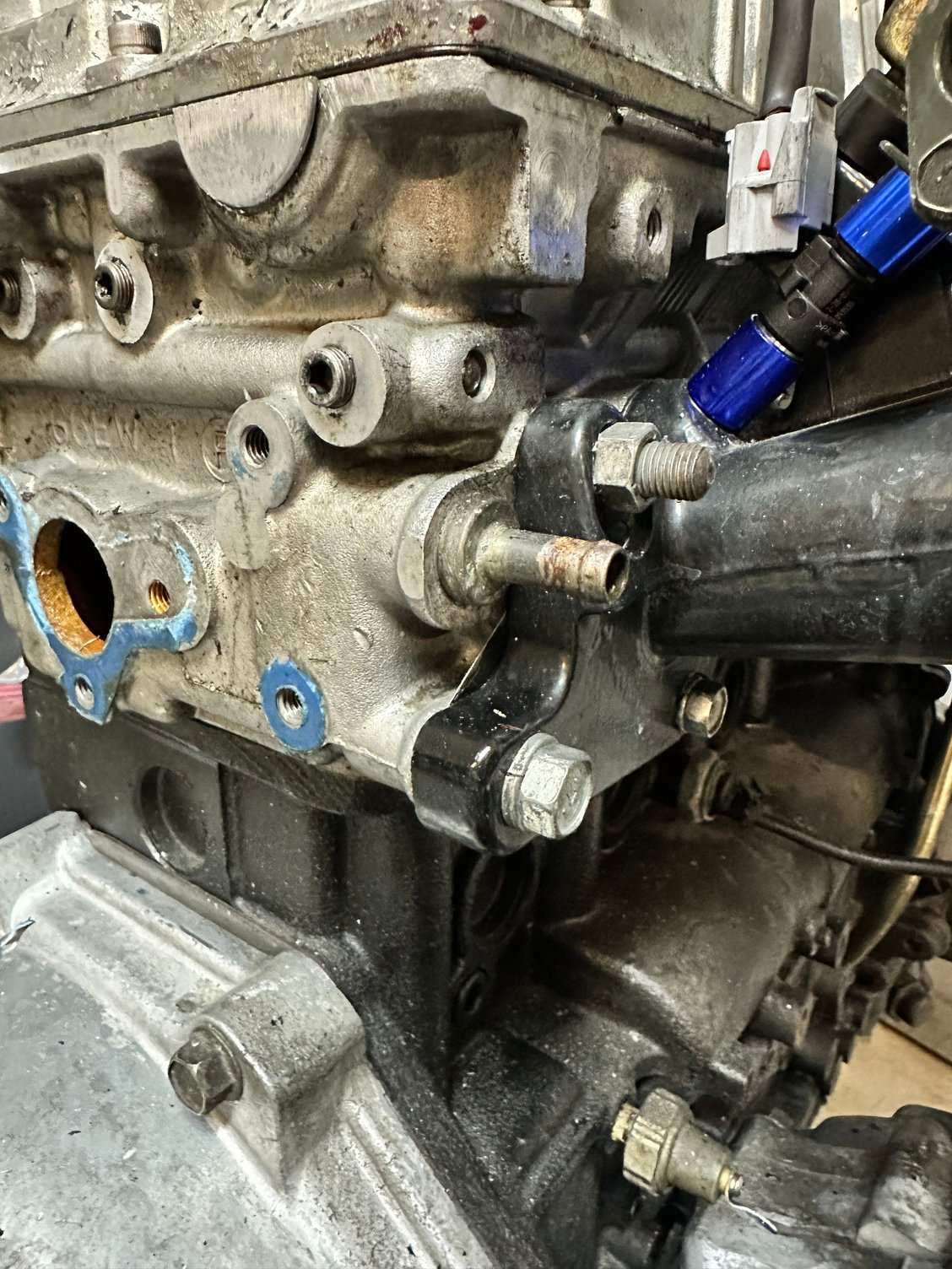

Is this port needed? Plan on pulling the barb off and block it off since I no longer need any more water ports?
head coolant port that can loop into water pipe or used for oem throttle body

That is for the throttle body. There's another one, same size, on the water pipe. Not needed. Easy button solution is to loop it to the water pipe nipple with one of the throttle body water hoses.

how do you plan to remove it ? Drill it out ? can you post once done ?
