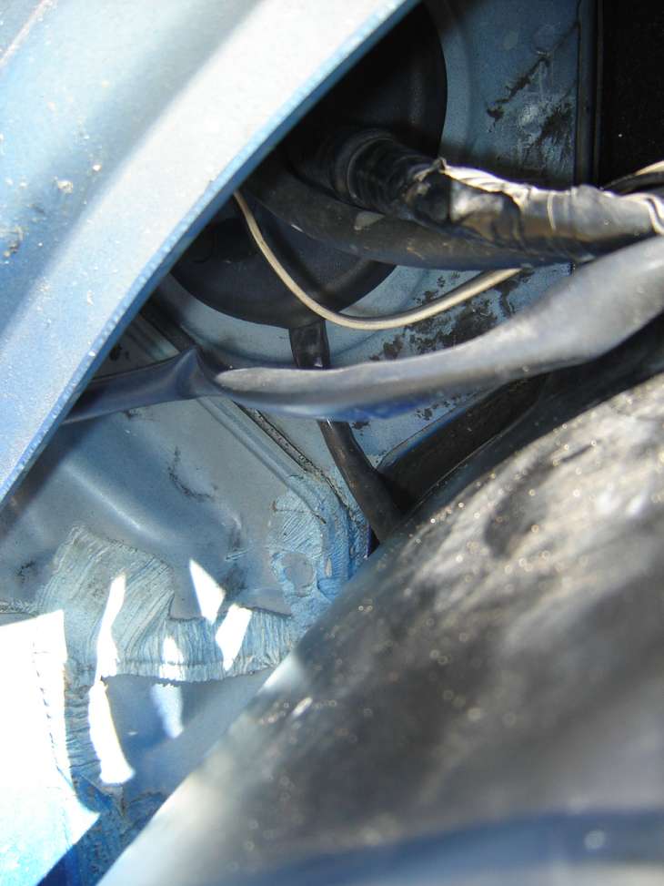

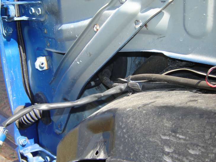

don't cut the wires!! there is a hole in the passanger side fender that you can use to gain access to the inside with out cutting anything. i will post some pics when i get home from work on my lunch break.

here,

it doesn't go throw the firewall, like in the pic take off the fender and you will see the ruber peice take it off and then look above the glove box on the right and you will see the hole.
