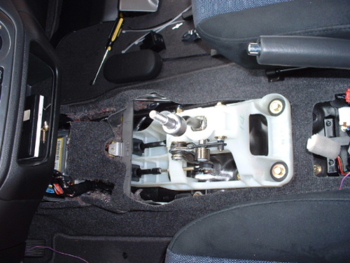

Try to support the shifter shaft (keep it from turning) by gripping it with a hard piece of rubber and some vise grips, or else you will be putting stress on the shifter assembly, which is mostly plastic.
shifter assembly pic
