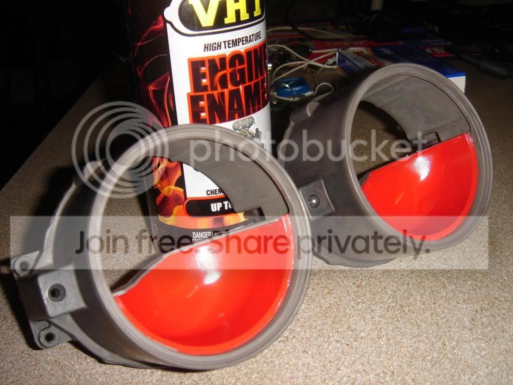

I'm thinking about doing my own headlights - when painting the projector lights (inside housing), do I need high temp paint? Same with the black paint for the headlight housing?
- Yes, High temp paint for the projector cutoff shields.
Notice the spray can in the background:
http://i527.photobucket.com/albums/c...I/DSC02700.jpg
- Black paint for the headlight housing doesnt necessarily have to be "HIGH TEMP"
give this paint a go:
http://www.krylon.com/products/fusion_for_plastic/
* Gloss Black - 2321
* Flat Black - 2519
* Satin Black - 2421
Ive heard some great results on headlights
