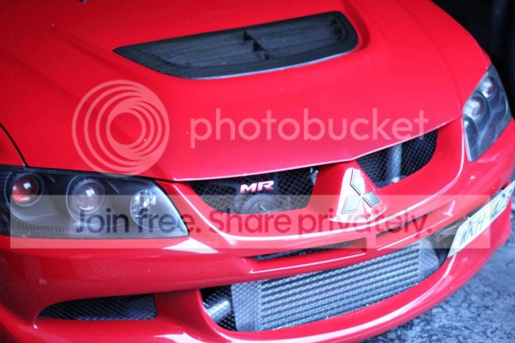

Update Pix:
Just waiting for the owner to send me offical pix...
1st CT9A quad set in the world with E46-R shrouds i might add
Old Aug 3, 2011 | 08:33 AM
  #81
iEvoVII's Avatar
Posts: 137
From: Darwin, Australia
Some more pix of
Red Qaud Projectors:

Ok, here are the specs of the headlight:
* FX-R BiXenon projector inplace of the OEM unit.
Why? This is why:
http://www.flyryde.com/images/products/TRS/LHDFXR1.jpg
The OEM CT9A projector doesn't come close to performing at good as this in terms of:
- width
- colorful cutoff
- intensity
* E46-R shrouds fitted into the low and high beam housings:
http://hidconcept.com/images/product...roud_e46_1.jpg
* OEM 3" glass lens fitted into high beam housing for the "Quad Projector" look ONLY. It dies not light up AT ALL. The rest of the OEM projector thrown away.
* Custom Aluminum shields made of cans of soda then painted red with VHT brake caliper paint (not sure on model)
* entire HL painted Satin Black, using VHT SP305 "Satin Black" sandable primer (final look)
