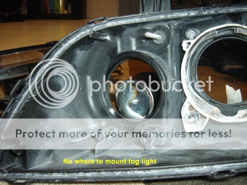

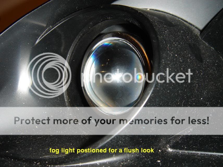

For a CT9A is it possible to put a projector in the "blank" spot where the foglight would be? (US spec IX GSR's dont come with anything but a fake chrome cap in that spot).

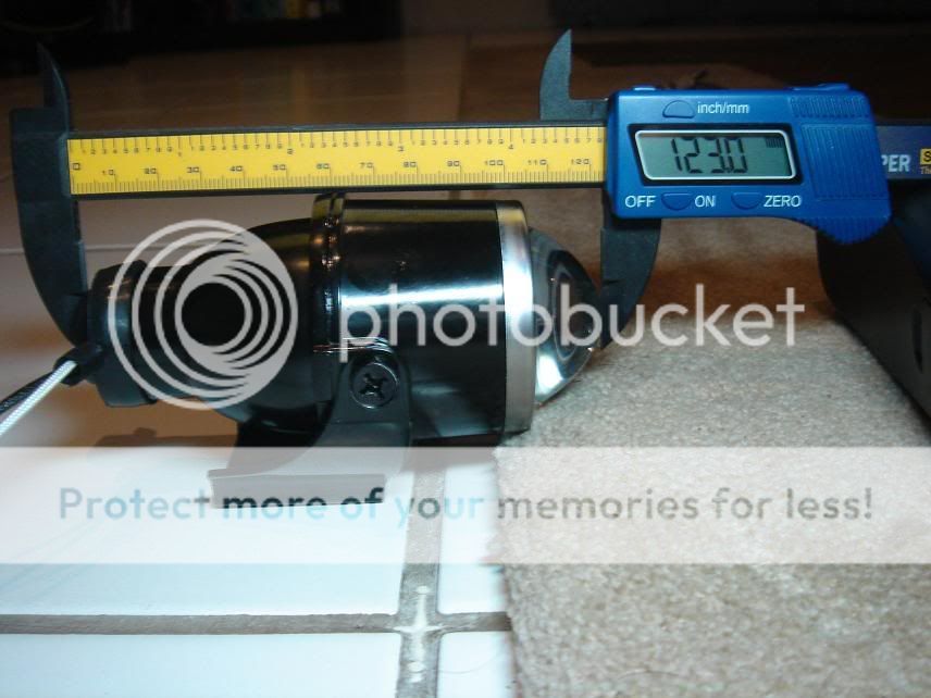

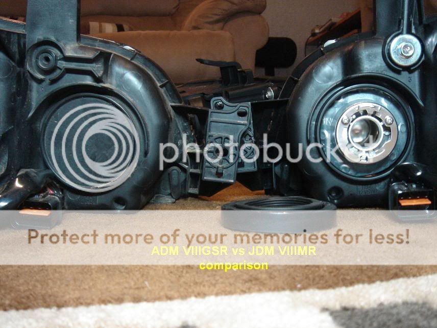

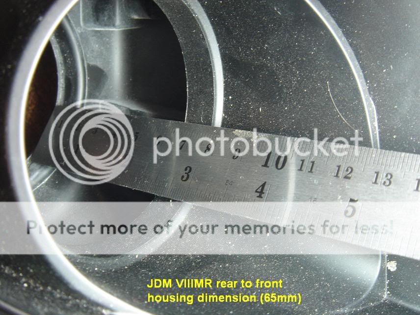

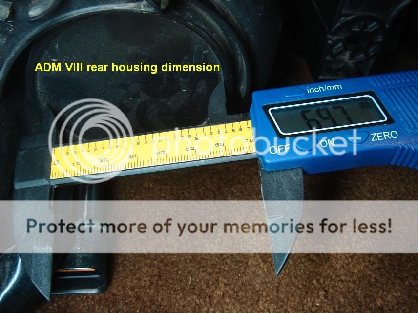

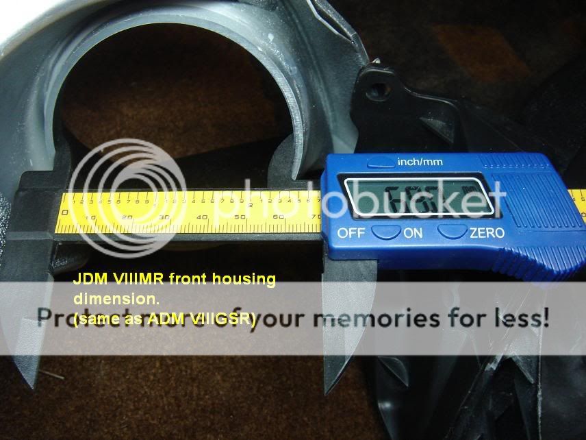

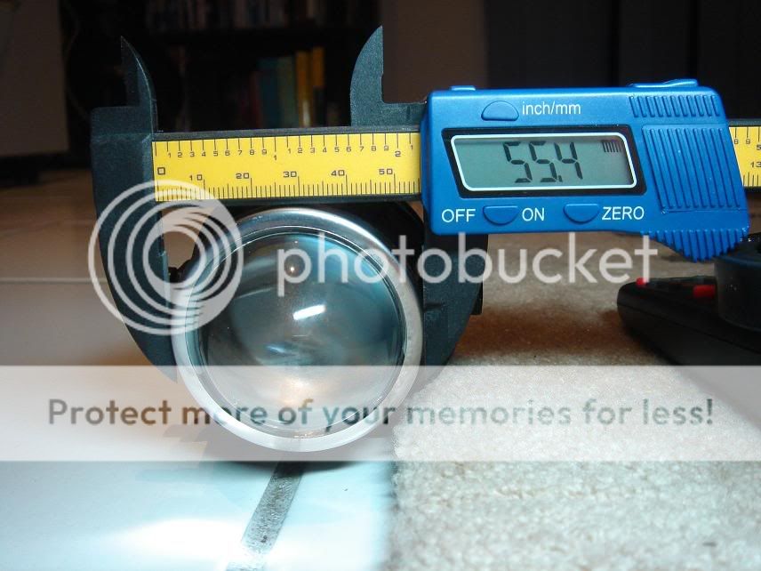

I was asked a similar qn in a PM..... heres what I said:
Originally Posted by iEvoVII
Yo .............!!!
thanks for your PM...
I have never retrofitted a whole projector into the foglight housing of a CT9A HL... I have however, fitted the 3" CT9A projector lens into the foglight housing. The rest of the projector was thrown away... owner wanted the "projector" look in the foglight housing...
Even fitting the smallest projector will still be too long. It will stick out at the back. You will have to resolve waterproofing issues...
Here's a IX that looks to have retrofitted a whole projector. Dont know how they've resolved waterproofing at the back...
http://i100.photobucket.com/albums/m...r/IMG_1940.jpg
JDM foglight housing is made of aluminum, it would be a pain to cut it and fit a projector... Not sure if the USDM foglight housing is aluminum as well..
Foglights only have up and down adjustment at the back.... No left to right... If you were to retrofit a projector you would need to get the left/right alignment soot on b4 you sealed the HL
In a nut shell, if you can resolve waterproofing, give it a crack...
That's all in the info I can think of from the top of my head... If I think of anything else I'll let you know
Cheers,
Stevo
In your case:
* That so called "Cap" is actually part of the chrome housing:
http://img709.imageshack.us/img709/9072/12e.jpg
you will need to "Dremel" it out and create a perfect circle.. I hope you have steady hands.. Also dremel out the rear of the HL...
* You have nothing to mount it to.... Cant mount to the foglight reflector like HID HLs coz you dont have one... There is also NO up/down adjustment screw like the HID HLs
These are the best pix I have in my archive relating to the foglight housing:
I never thought to take pix from behind
