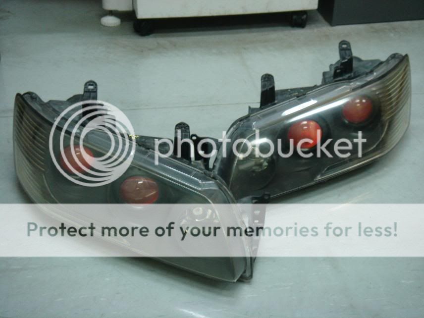

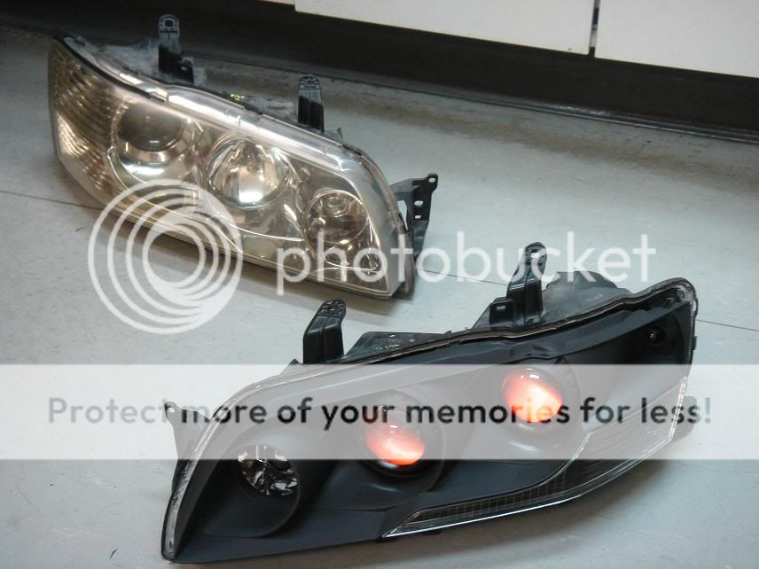

The first Quad Projector set I'm doing besides my own.
45% done....
These are VIIGTA headlights for an VIIIMR onwner.
Headlight specs:
* OEM Single Xenon projector replaced with an FX-R BiXenon projector (Low & High beam)
* OEM chrome shroud dremelled away to fit an E46-R shroud in the low beam housing
* Front half of OEM projector retrofitted in the high beam housing for the "Quad Projector" look only (non functional)
* High beam housing dremelled to fit an E46-R shroud
* Custom aluminium shields painted red and installed to make all projectors look red
Owner will be installing an aftermarket:
* 50w rated D2S bulb (4300K)
* 50w Ballast &
* BiXenon wiring harness

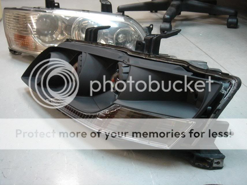

Where do you get the clear lens for the turn signal?
Old Apr 18, 2011 | 02:31 AM
  #67
iEvoVII's Avatar
Posts: 137
From: Darwin, Australia
Originally Posted by Evolutionary8
HOW DID YOU CHANGE THE OVERLAYYYYY!!!!! sick nasty
By "Overlay" you mean the housing that's now painted black???
Like I said before, I had to dremel the low and high beam housings to fit E46-R shrouds... Google "E46-R shrouds" if you don't know what they look like..
The ONLY CT9A headlight ever made that had the clear turn signal internally was for the 2002 JDM VII GTA (Automatic).... Google it
