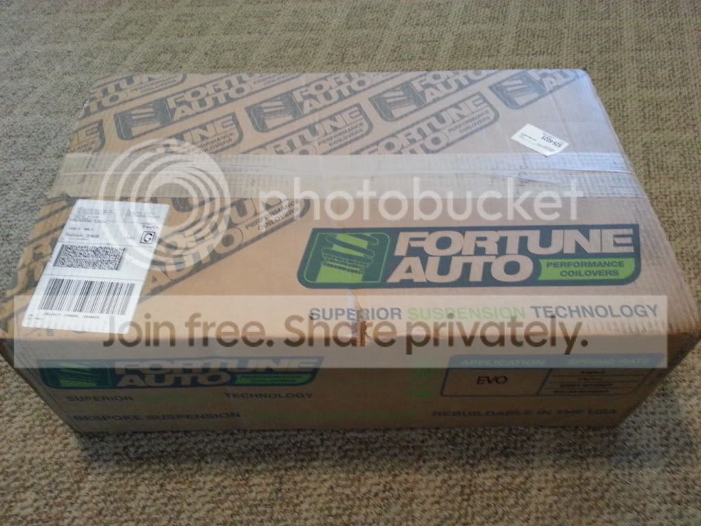

Clean build! There a pn for those FA coilovers?
Originally Posted by Alchem1st
Look what came in the mail today!!!!
Fortune Auto 500 coilovers for an Evo IV with 8Kg Swift springs front and rear and radial bearings preinstalled. Had them valved for street use.
Old Feb 3, 2015 | 10:48 PM
I got mine through MAPerformance if I remember correctly. Just shoot them a pm and tell them what you need!
