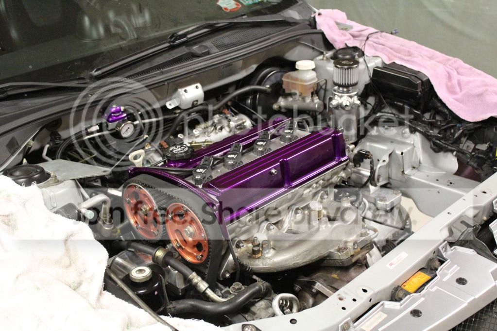

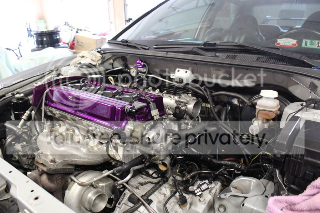

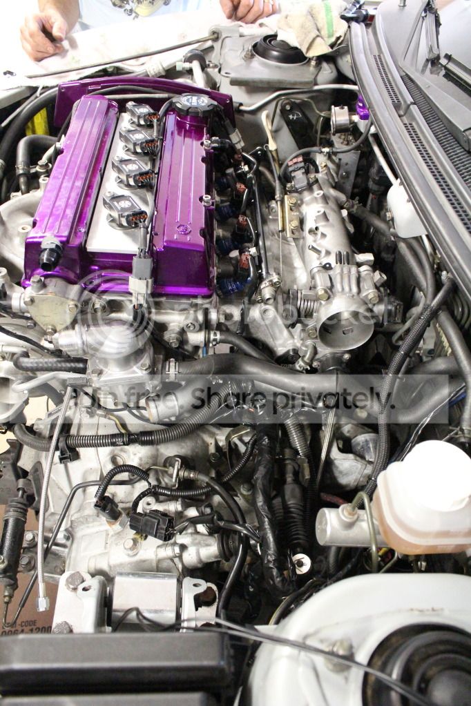

The tuck is done!! I'm just waiting on loom. Here are a few teasers with just the wrap, no loom.
