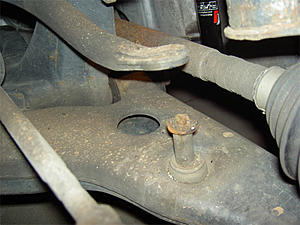

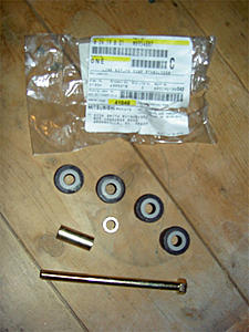

my solution...
i had the same clunking noise from the left front tire when i would make a right turn and sometimes when i hit a bump. i looked under the car and couldn't see any problems, but once i lifted the car i found that both sway bar links had sheared off. whenever the lower conntrol arm would lift, it would hit the stub of the linkage bolt.
replaced both swaybar link kits (mitsu part #MR954887 - one kit for each side, i paid $10.82 each) - the noise is gone and the car handles much better (as you would expect). the parts number is for an '02 Lancer OZ Rally
(pics are attached)

thats exactly what happened to my car, on the passenger side..
