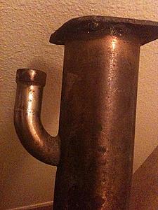

For what its worth, on my VIII, we made a custom cat delete pipe, with the premise of removing the o2 sensor out of the exhaust stream. It never threw a code on my car but I don't use it anymore since I have Autronic and new DP that has delete built in.
Looks like this horrible picture taken with phone
Yeah, that will work or you can use an ebay fix (which is the same as the spark plug anti-fouler).
If you are getting the code for the heater you can disable bit 1 of periphery 2.
