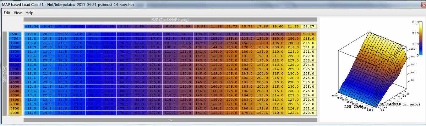

This is my first full revision of the map load tables. it's mostly just smoothing the stock table getting rid of the peaks and valleys.
Attached Thumbnails The 3xMAP/MAF tables-revisedmapload_1.jpg

I've always assumed that Mitsu made that map look that way for a reason.

Actually, it has nothing to do with error correction, i have had ec turned off for several weeks now just running straight duty cycle with a 3port. I think the issue is the gate port is too large for the turbo... at higher boost anyway... gate opens, turbo slows down so much that boost drops then the turbo has to spool up again... I've got two things left to try, upgraded bov and putting a turn or two on the actuator rod.
Anyway... made a few pulls on the updated MAP load tables this am and the car felt great, as smooth if not smoother than ever.... load seemed a little more stable, fueling was a little more stable than previous maps.... will do more testing over the weekend.

I smoothed out my VE/MAP tables as well awhile back and it makes a pretty substantial difference in smoothness and logging smoothness.
One thing I posted about awhile back is when I did my turbo swap from the stock RA turbo to the BBX lite, when I kept the RA VE/MAP values the car would run too low load values for the boost being used and would also trigger the ASC light every time at WOT, even with ASC off, copying over the Evo VE/MAP values cleared it up and it ran proper load values.
I've also changed these tables for the stroker builds. The cars would always run odd until I did that.

Yeah,
It's really strange, these are not true VE tables as you can tell from the shape of the graphed tables. They almost remind me of boost comp tuning with AEM. Way back in 2008 when i was working with ecutek and had issues post MX-1 cam install the Ecutek guys mentioned that the ecu used a combination of maf and speed density that made tuning for cams etc a PITA.... Now I see what they were talking about.
It seem the main thing is to make sure the maf load and the map load are in agreement with each other within some degree of acceptable error.
Once again this points to the need to be able to log both load values so that the required changes can be made.
To your point about upping the clutch clamping pressure Bryan... I would assume that if both the maf and map tables were adjusted accordingly, one could easily accomplish this.... So long as any preset load limits that may exist in the tcu are not exceeded.
I doubt I will come across the need to up the clamping pressure while on the X turbo.... but you never know.. If I want to push the limits and spool the turbo as early as possible.... I may play around with upping both sets of tables once i do the swap.
