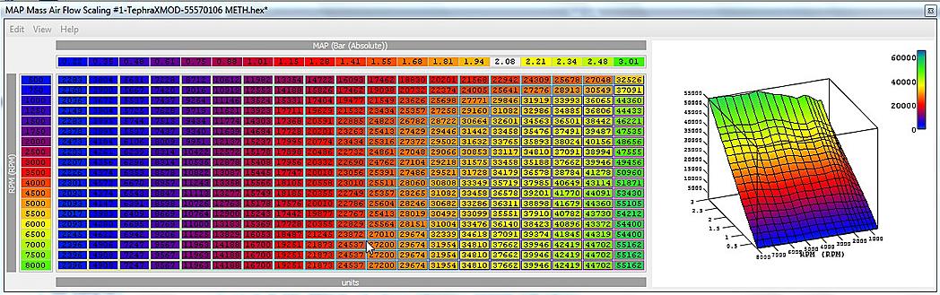

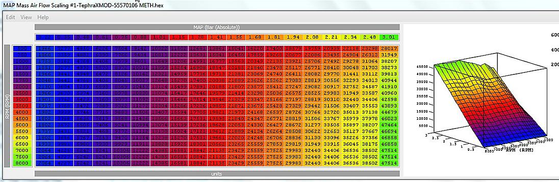

OK so I am guessing it should look like this...
The map on the left is increased 15% from the second one. Now I guess I just have to do the other 2 maps
I would also smooth it out more, and more importantly, get the correct scalings.
Code:
<scaling name="StockXMAP in psig" units="StockXMAP in psig" toexpr="((x/4)*0.19347)-14.5" frexpr="((x+14.5)/0.19347)*4" format="%.2f" min="-15" max="35" inc="0.05" storagetype="uint16" endian="big"/>
<scaling name="Loadify" units="%" toexpr="(x*10/512)*10/32" frexpr="(x*32/10)*512/10" format="%.1f" min="0" max="300" inc="1" storagetype="uint16" endian="big"/>

Ok so I added that and the chart still looks the same.
Code:
Now that the scalings are in your XML you need to make sure those tables use them. Either change it in the XML by hand or in Ecuflash via the drop downs.
If via the XML, should look like this:
<table name="MAP based Load Calc #1 - Hot/Interpolated" category="Fuel" address="YOUR ADDRESS" type="3D" level="2" swapxy="true" scaling="Loadify">
<table name="MAP" address="YOUR ADDRESS" type="X Axis" elements="19" scaling="StockXMAP in psig"/>
<table name="RPM" address="YOUR ADDRESS" type="Y Axis" elements="19" scaling="RPM"/>
</table>
