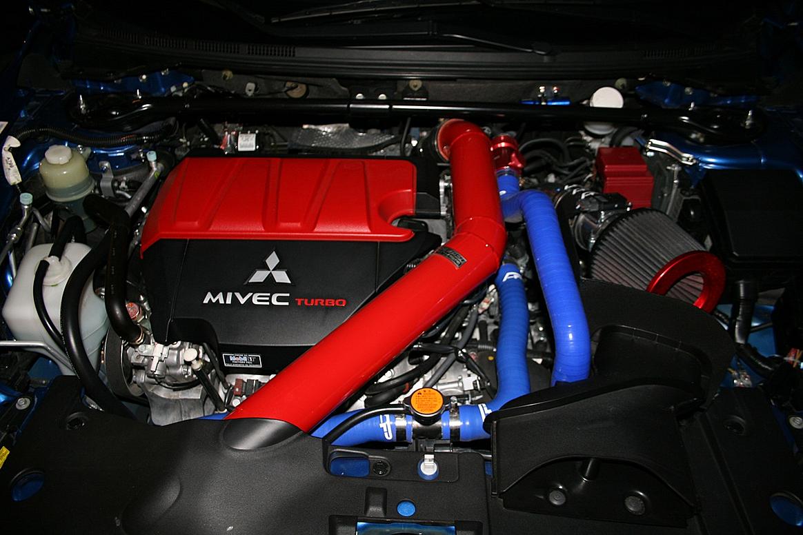

I have the agency intake as well as agency bov and uicp. I originally did what you are talking about and moved my bov to the front below the intake... bad idea. I had to move it back because in order to get a good custom tune I had to recirculate. The only way for this is to keep it where the stock one sits. I had to buy a new bov return hose from agency to fix my bad mistake.... So if I were you I would leave it. I will get a picture of mine up and so you can see it.

The bov return I bought from agency
