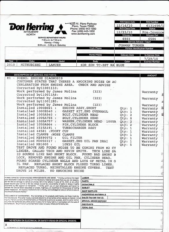

heres a link to my problem with the detailed paperwork from the dealer
https://www.evolutionm.net/forums/09...e-problem.html
here's photo of paperwork
https://www.evolutionm.net/forums/at...roblem-img.jpg
millage was 6503
was hearing akward noises coming from the engine
cylinder #2 had gone bad and there was metal in my oil pan
oh and my car is completely stock. absolutely no work has been done to it
