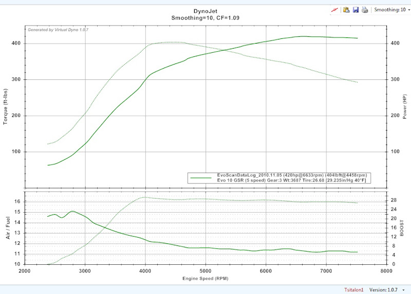

Originally Posted by tsitalon1
Here is my green on the Virtual dyno:
Here is my Green turbo "feelings":
https://www.evolutionm.net/forums/ev...n-journey.html
Enjoy!
nice is that 93 pump?
