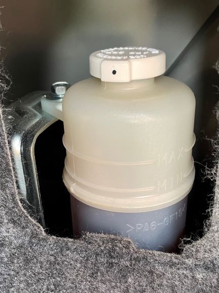

I've had my Evo X for almost 10 years now and have about 54k miles. I've had bolt-ons, EFR 7163 kit (From CBRD), Exedy Twin Disc clutch, tune, etc. for about 25k miles. Today I went for a ride and noticed the Tarmac light was blinking. I pulled over and scanned the car with my Cobb AP and it showed a CEL of C161F. I kind of assumed that this was the dreaded ACD/AYC pump issue due to corrosion but saw a few posts that this could be due to low ACD fluid. The first time I took a look, the fluid was at the minimum line:
ACD - half full
When the car is parked for a while, and I take a look at the fluid level, it's on the max line:
ACD - full
Is it possible I just need to top off the fluids a bit or is this wishful thinking and should I plan on seeing if Mitsubishi will cover this or not? I know the latter is unlikely but I thought I read that Mitsubishi finally admitted that this was a design flaw and started covering with no questions asked in a lot of cases. Not sure if this would be better suited for this thread - https://www.evolutionm.net/forums/ev...merged-38.html. Any help is appreciated. Thanks.

That's normal ACD pump fluid behavior. Your pump is probably toast. My '11 Ralliart was on it's third pump at 120,000mi. Mitsubishi extended the pump warranty out to 10yr, 100,000mi. If you're over that, good luck.

Fluid level is normal. Time to get the pump replaced

Thanks guys. I'll cross my fingers and see if Mitsubishi will cover this. Keep you posted.
