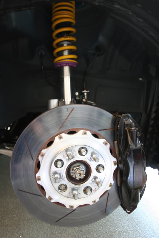

Originally Posted by e55nEVO9
hahahaha
but brownbos still look ugly!
Brownbos...yes. BUT blackbos are awesome!

Old Jul 3, 2008 | 07:54 AM
Hiboost's Avatar
Joined: Apr 2005
Posts: 3,222
Likes: 8
From: Rochester, NY
I wonder if once you cook the stock calipers black you could re-paint with a higher temp paint without having to strip the stock paint? Seems like a good base coat haha...
Way to go tracking the car, hopefully you will get the AYC back again.
There really isn't any higher temp paint that's going to last. I've had several Big Brake Kits on my other cars, and they all turn black. So I just buy a kit with black paint. And if you look at SCCA racing cars, they usually don't paint the caliper.
