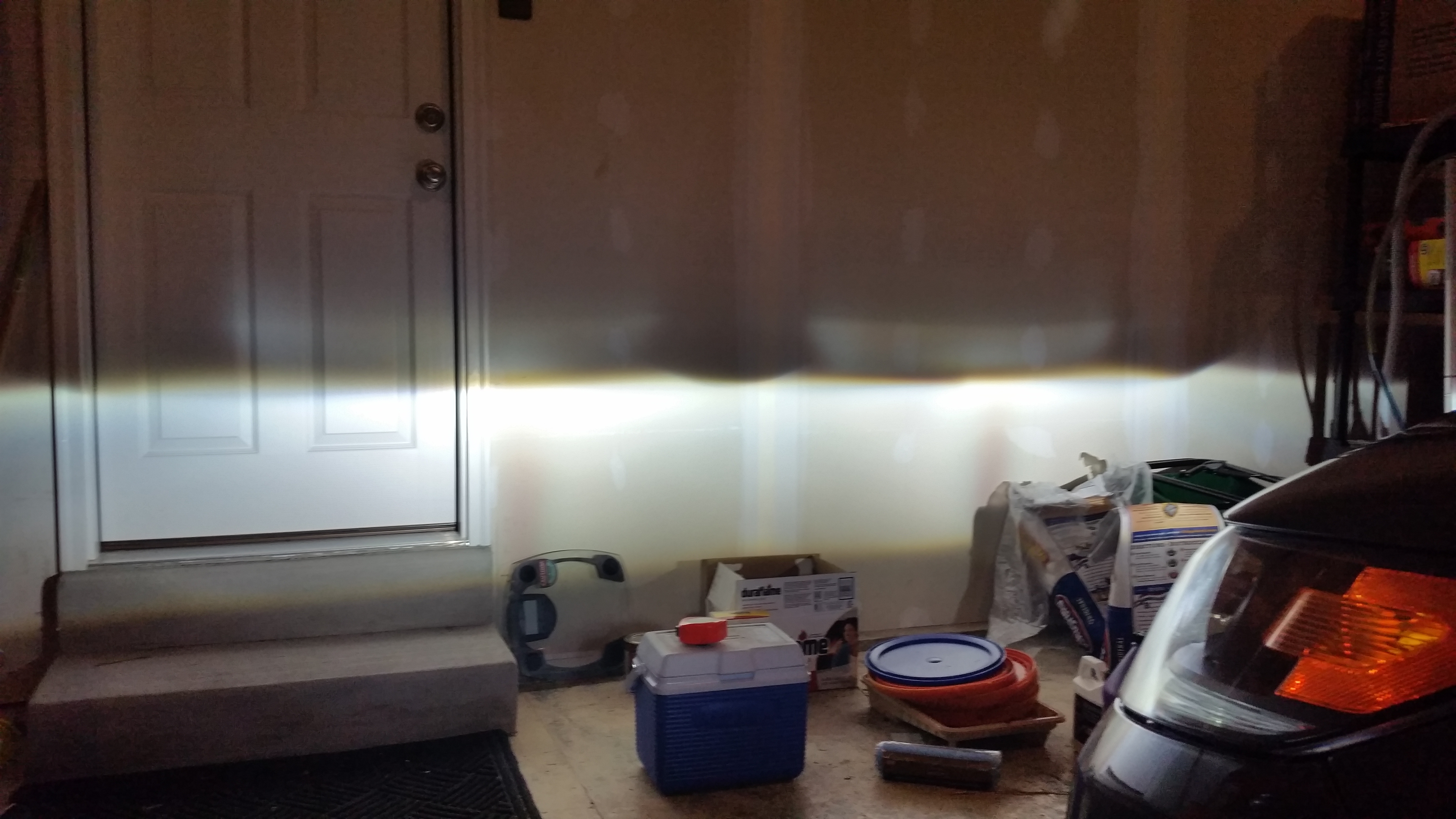

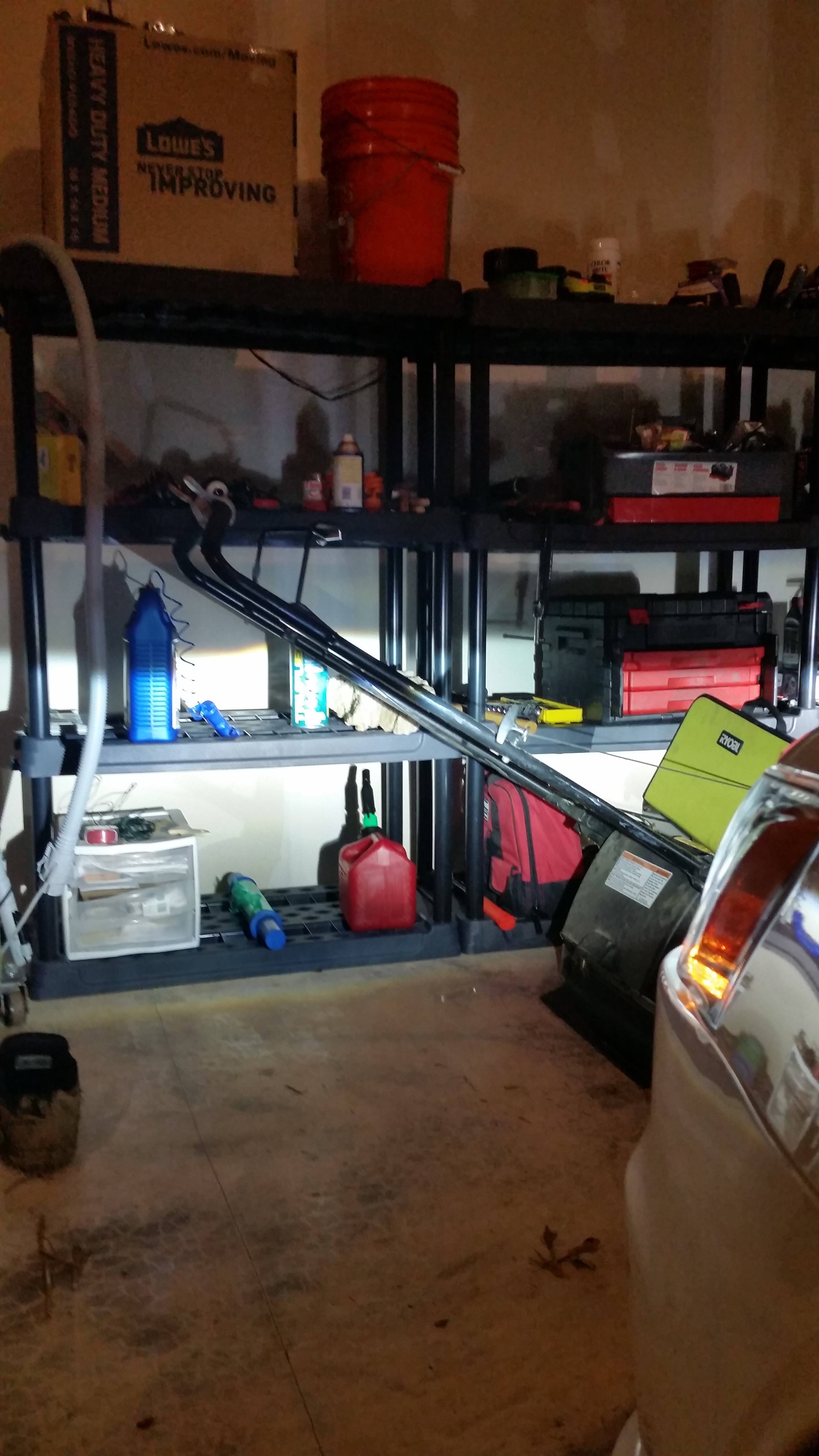

I did two pics of the accord and one pic of the evo with factory hids for reference.

Thanks for the pics!!! Coming through in the clutch! Appreciate that. Now I have to do this mod. lol
