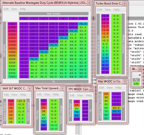

I am hoping someone can assist me in explaining why the WGDC is being corrected in my log by +10% even though i have my TBEC table zeroed out.
From the attached log and WG tables, is anyone able to advise what is causing the correction?

Zero out max total upward correction.

Jay thanks for the response mate.
Are you able to advise why? i thought that table was just a limit to how much correction can be done and not an automatic correction.

are you sure you are logging the correct address? the WG and correction should be both zero at idle and even light part throttle. well it is for me.
im nto sure if maybe there is another table that determines WG activation against TPS, but mine doesnt activate till after 50% throttle. well thats what it feeld like.
the max fixed my issue and no more correction.
cheers

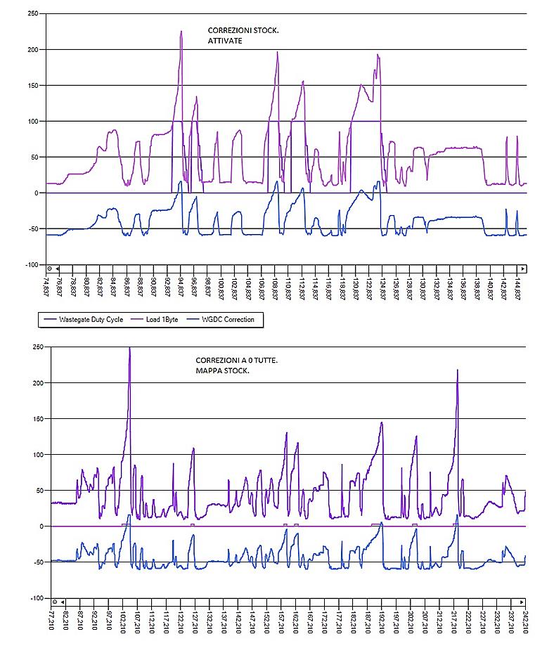

i'm logging with evoscan...
i can't find the problem... i have same result with tephra mod and with stock map.
which are the correct address?

The first picture is with stock correction table .
Correction starts at 86 of load and this is ok, but at idle i still have -64% correction.
the second picture is with ALL correction zeroed out .
there is something i can't understand .why this situation?

Max total upward and Maf iat both are affecting correction

in his situation yes, but in my situation i zeroed also Max total upward and wgdc vs iat..
I don't know why my car wgdc response like this
