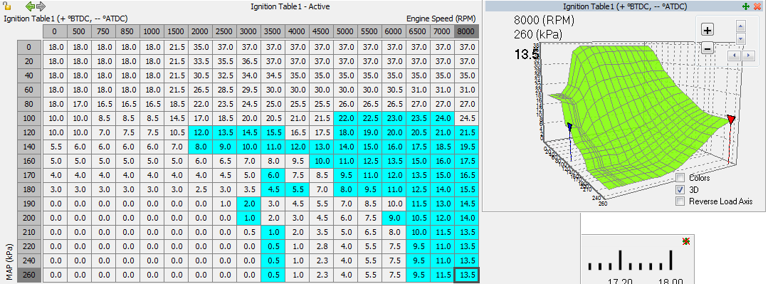

hey guys, I figure I would start getting a base timing map ready for when I fire up the vipec. Based on former ecu flash knowledge, I tried to stay on the conservative side. Plan is run boost within the maps range. I think the scaling here is good til 23.72 psig at 14.5 atm.
Does this look good enough to start with out being any where near aggressive on 93? I think its a bit conservative @ cruise, and peak load (3500-3750) but I just want it to run well enough until I get det cans and set up knock correction.
GSC S2 cams, Skunk2 intake mani stm ported, 3.8 ic core, 3'' tbe catless
heres my mivec map that I think will be a good start. Changed from TPS values on the Y axis to MGP
Attached Thumbnails OFFICIAL VIPEC THREAD - V44 PnP & V88 Thread-vipec-base-map.png   OFFICIAL VIPEC THREAD - V44 PnP & V88 Thread-base-map-vipec-vvti.png

Where are you going to set your idle RPM? If its going to be at 1000rpm I would get rid of 0-750 that way you can free up those cells for a little more resolution where you need it, like in the peak tq areas.

  #102
211Ratsbud's Avatar
Joined: Oct 2010
Posts: 4,286
Likes: 43
From: Watertown, NY
Not sure on idle just yet but I will heed that . Hopefully at 1000 even. How does the vipec handle situations where you go out of bounds? Just applies a clamp?
Do those timing figures seem conservative though?
Does map or mgp offer more consistent operation in changing environment ?

Figures looks about right.
If you go off the map it will just use the last cells it was on. So if you are running 28psi and your map is set at 26 psi it will run it at the 26psi portion of the map.
I have mine converted to PSI, MGP or Map are fine. They are basically the same thing. You will be fine with either.
I idle at 1050-1100 and I have my map starting at 1000rpm, same with my Mini, and every cammed mini I tune.

It looks similar to the stock evo table.
