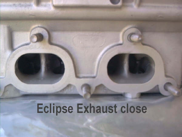

pjal84's Avatar
Joined: Dec 2001
Posts: 2,722
From: Up to 80 miles north of Gilroy
You are wrong. Different engine families.

Old Jul 10, 2003 | 01:37 PM
EvOZrally7's Avatar
Joined: Oct 2002
Posts: 43
From: Woodbridge,Va Northern Virginia
They look close as hell, and by the way, sorry no need for the tude just puttin in my 2 cents.
The only thing that looks off is the ports thats it
Also how about takin a picture of the middle of the eclipse head instead of the right side of the exhaust port side. also what about the pic of the whole head instead of just 2 ports that would be nice

Old Jul 10, 2003 | 06:22 PM
pjal84's Avatar
Joined: Dec 2001
Posts: 2,722
They may be similar but then again, most exhaust ports would granted as essentially they're holes in the block. Mirage guys would've done a simple turbo manifold swap if it was that easy, so the answer is still no.
