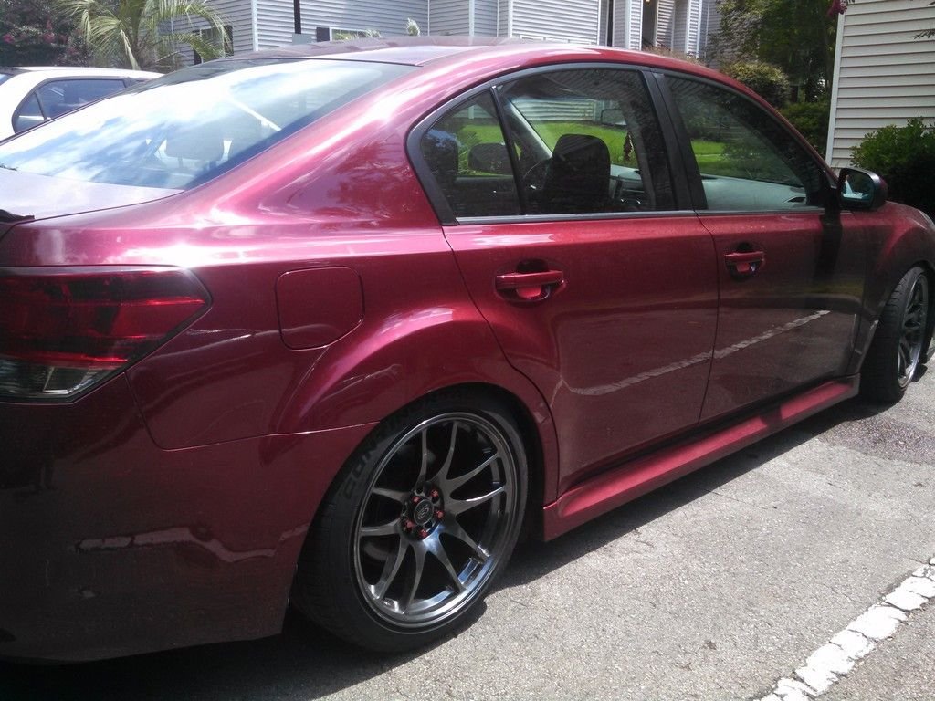

Thats a wrap
Well I recently bought a new ride
2010 Ruby Red Subaru Legacy GT (LT leather package)
Came with a few extras like Rally Armour flaps, retrofitted Halos for the HIDS, coilovers, and wheels and tires.
BUT I didnt sell the lancer. I still have her! I'm just going to take her off the road for a little while and fix her up.
But enough of that. Here are some pics. Enjoy!

Nice. Let me know if you need anything for the Legacy or any help with it. I work at Subaru now.
