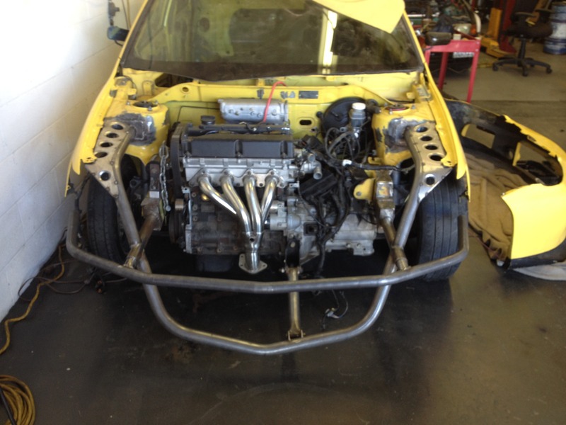

Its been a while but heres a small teaser of the tube front I'm building. 1 3/4" .120 wall DOM tubing. its all going to tie into a 6 point cage inside when I'm done.

Pretty sweet build. I went thru the entire thread a few weeks ago and was wondering if you finished.

I guess this update answers your question..lol I'm a long way from finished. I think I have decided to fab my own turbo manifold since now I have all the equipment to do so. The possibilities at this point are endless so I guess whenever I can get myself to stop thinking of new ideas I can call it "finished".

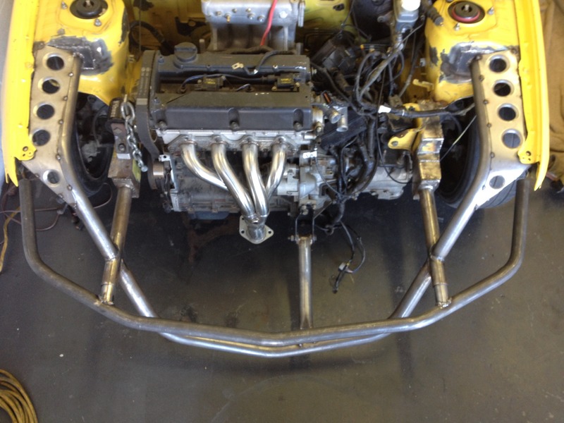

Just a small one. finished up my front solid engine brace.

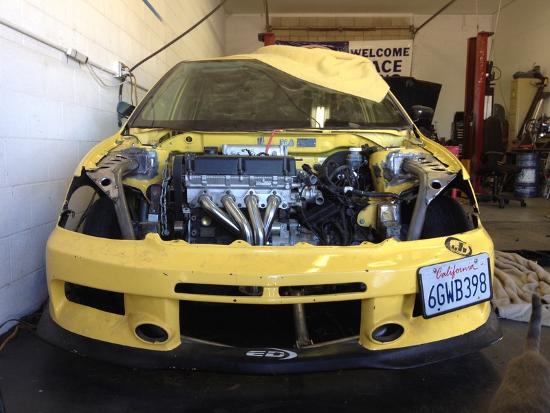

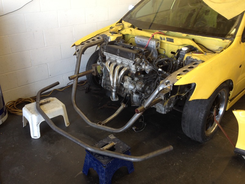

Update!
I decided to put in a little work on the lancer in the last few days. Finished up a lot of the tube chassis front end. I'm pretty happy with the way it turned out.
