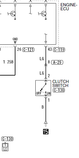

Originally Posted by *02Lancer*
I will want the information on how to get it but first i have to find a dang ecu :P they all sold! lol
Pin 43 on the Evo ECU is the CLUTCH SWITCH INPUT. This input is triggered when the clutch is depressed, causing the ECU to reference the Stationary Rev Limit seen in EcuFlash. The Stationary Rev Limit value in EcuFlash is referenced only when the clutch is depressed, not when the car is not moving or in neutral.
A signal wire coming from Pin 2 on the clutch switch needs to be ran to Pin 43 on the ECU harness. I believe there is an EvoM member in the EcuFlash threads that sells pins for adding extra wires to the ECU harness. I can't recall who off the top of my head.
