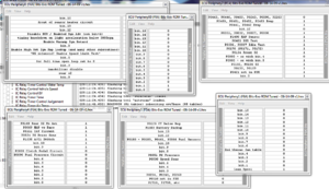

All of these are already defined in the Evo's ECU periphery bits if you use the newest version of EcuFlash and add the blobbits variable (See here: http://evoecu.logic.net/wiki/Periphery_Configuration).
None of them are required for this swap so I felt no need to include them and to confuse readers more than they probably already are, but you can see all the different bits on the Evo ECU that can be modified in this image:
