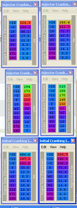

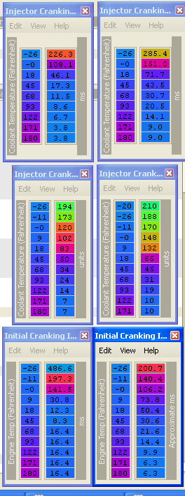

In addition to everything the guru says, try using the attached pictures, and matching them up with your ROM's startup IPW tables. Your current ones (from the last rom of yours i have) are on the right.
Also, the second pic, is Post cranking transient enrichment, put it in for both of your post cranking transient enrichment tables. When I tried what you have, I got the same sensation of having "bigger cams" type feel/sound.

Ok, ill go ahead and give that a shot and let you know what happens, ill get it up to about 206*F again and see if anything changes in the log. So the evo's with modded injectors are having trouble as well?? Must just be some fine tuning to be worked out, im sure we can work this warm start issue out, just have to figure out one thing at a time! But ill give that a shot, increasing those tables a bit and see if the log reflects any changes.
Ok, i will try that and report back! Yeah that "cammed" type feel and sound is what happens every time, even when cold, i mean at cold it starts easyer but still stumbles, so ill report back in like 15-20 min!
