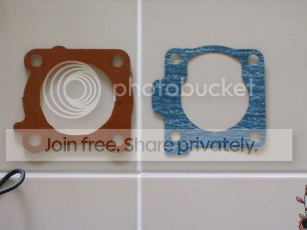

ok I ment to mention this to you guys I couldent use the throttle body spacer that I bought it didn't seal the IM and TB.... I talked to accolade sports parts and they told me to contack RPW so I did and they asked me to send them a pic of the spacer and stock gasket here is a pic of the spacer and the stock gasket that I sent them ( the reason the spacer didn't seal was because it doesn't have the little tab on the left side of it like the stock gasket
now that I have sent them that pic they want a pic of the throttle body but I'm not taking my car back apart.... . if anyone could scrape up a good pic of the manifold side of the throttle body for me I would greatly appreciate it

YEA that spacer really is not right. Lancer Manual is very specific on gasket placement. You cannot even have it flipped backwards or it will cause a problem so that spacer would cause a problem for sure.

I hope I put the gasket in right...... what happens if it were flipped backwards? wait.... there is on;y one way it can go on and line up right? cause everything lined up good so I should be ok right?
