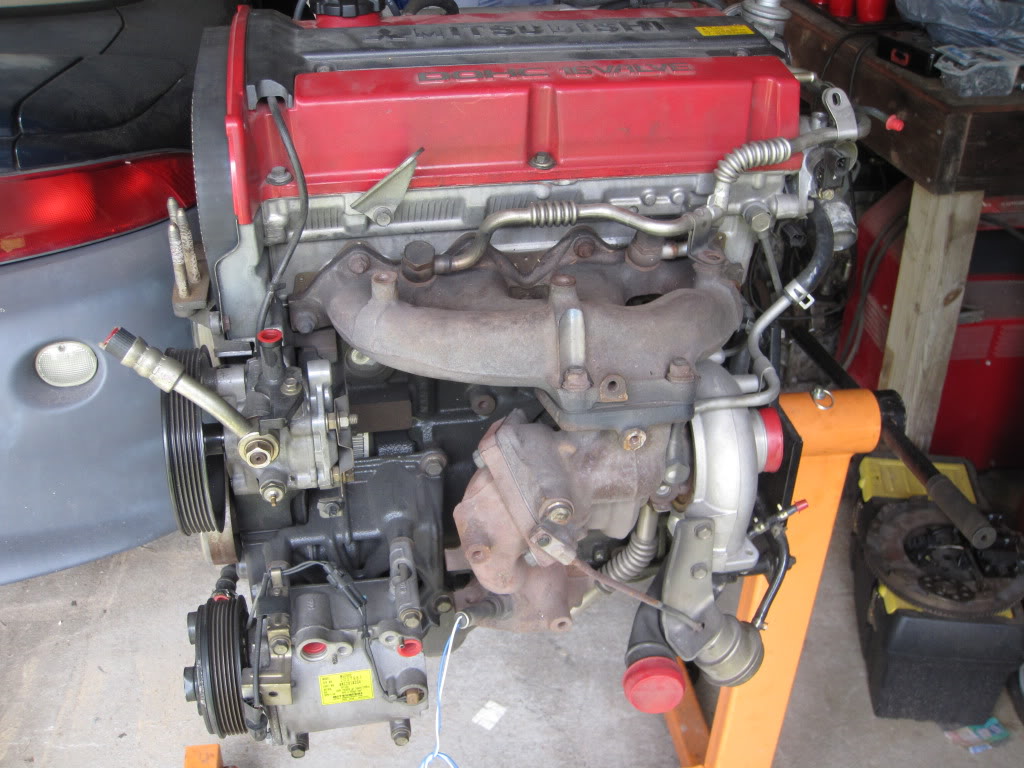

Well, bad news , good news. What now... Do I put it in FWD format in the lancer, and make a writeup to show people its easy and can be done all day long... Do I buy a galant and do a Manual transmission and engine swap make a write up for it do it fwd or awd... Do I buy a 3g spydur and swap it awd or fwd ... Do I roll it in the corner cover it up and wait until I can afford a 4G and swap it into there... Do I buy a 88 2 door montero and make a sick RWD pajero... To many dang decisions here...
