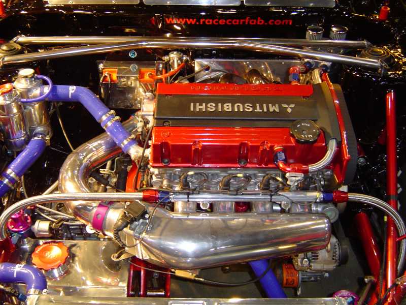

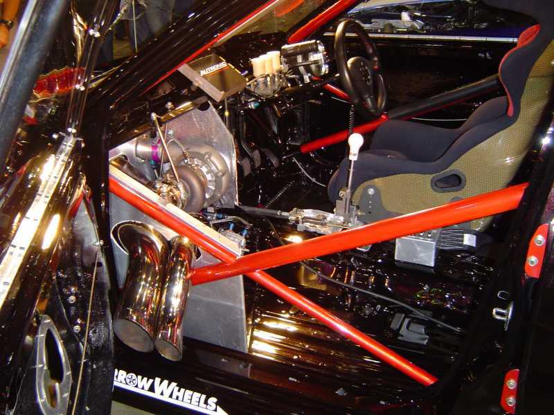

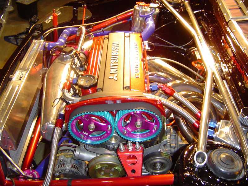

Here's what someone had to do to get a Evo IV motor into an Evo III. Its the same idea you have, just backwards and it most certainly is not a daily driver. In other words, you should put that 2 grand into getting an Evo IV+ motor for your car. Then you'll start off with bigger injectors ~510cc's and a big 16G turbo, both of which will get you close to 400whp with minimal bolt ons, some race gas and GOOD tuning. The T-25 that comes stock with late model DSM's is good to about 250whp max.
