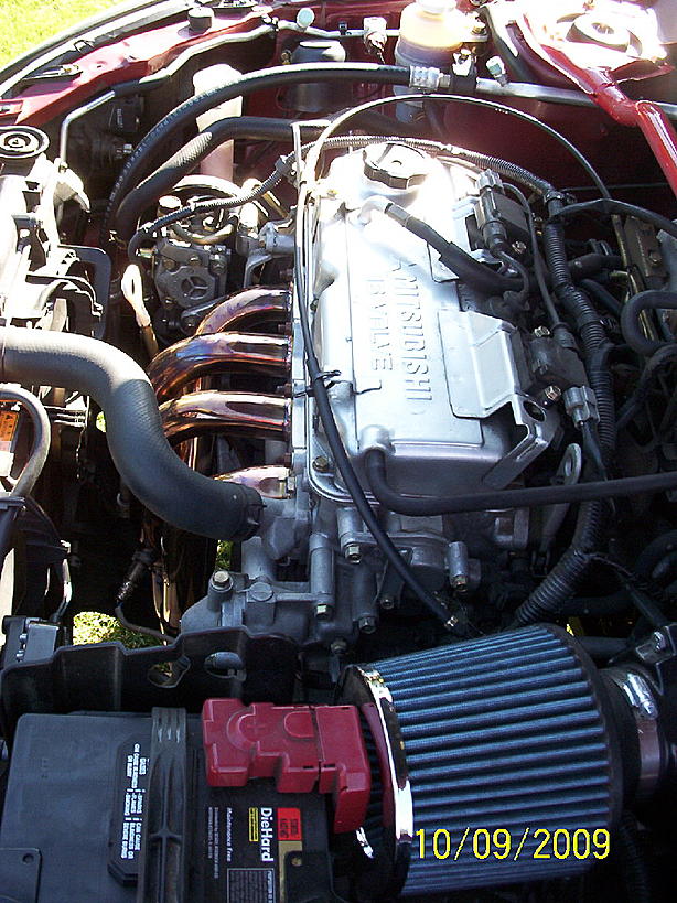

Still motoring on...

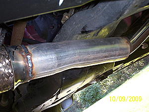

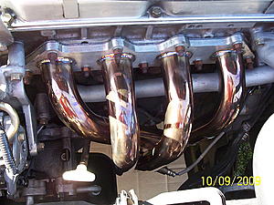

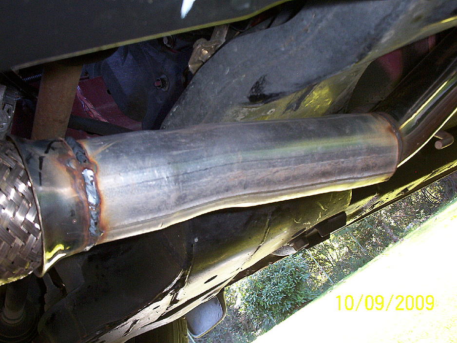

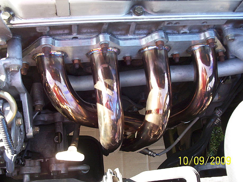

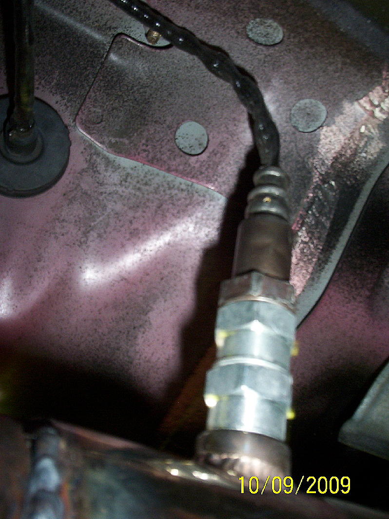

So far so good on the second fouler and haven't gotten any dreaded yellow lights on the dash. I heard that the CEL light gives you at least 2.5 HP.
Anyhow, here are some pics of the final product.
