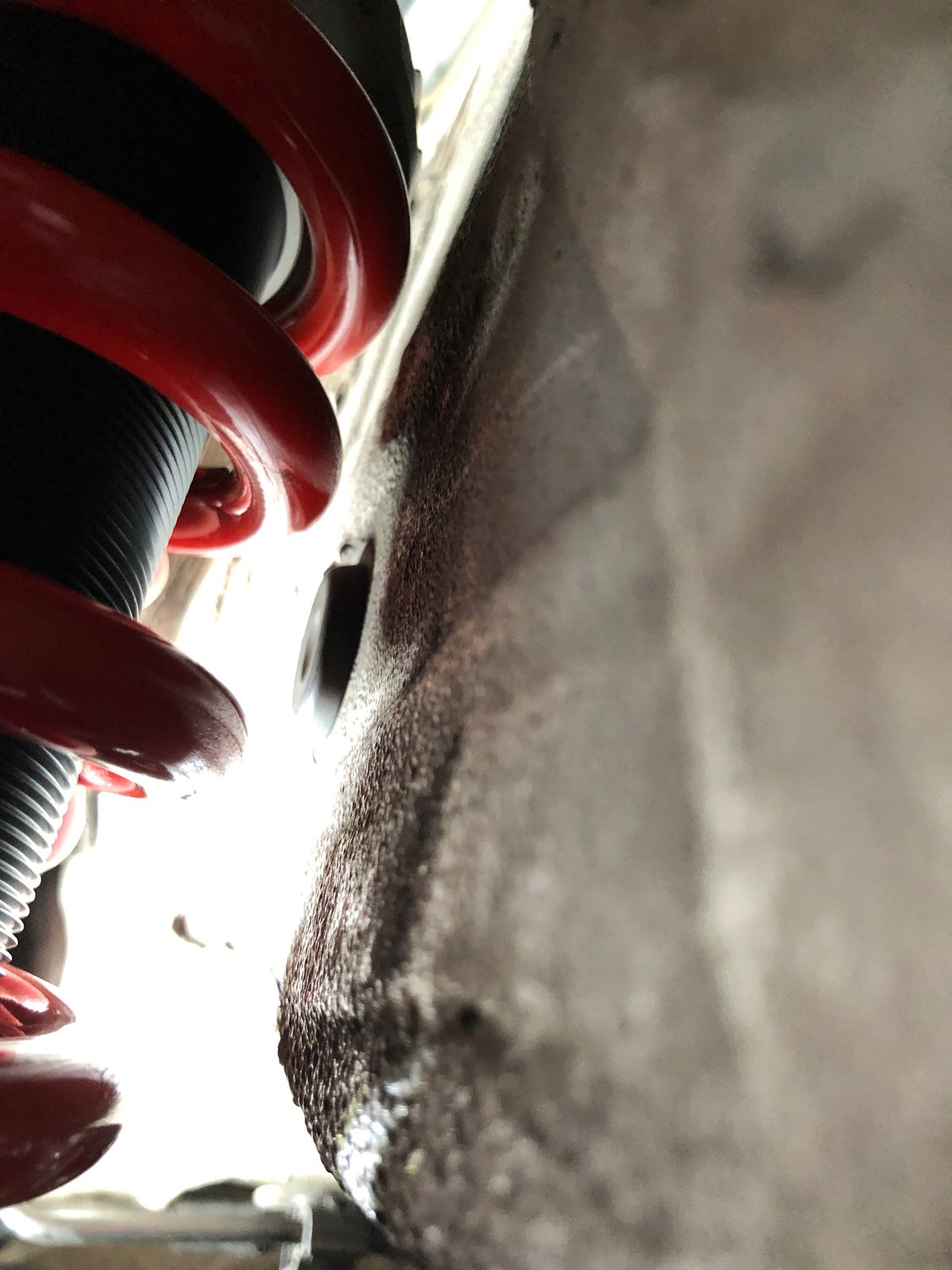

Took some photos. I was mistaken, the spring doesn't hit but it's VERY CLOSE. This is at full droop so I would imagine there could be a chance of it hitting when lowered since the strut is mounted to an arm and I'm not sure how it sweeps, if at all.
So you wouldn't need much offset to get clearance, however, the real issue is that the spring hits the sway bar. This is a short 6" spring too. Perhaps the Feals mount the spring high enough to clear?

Hmm... that is interesting. Looks like you can't even get the spring adjusters in? Offsetting the top would only make that worse. What would you say, the spring would have to be 2" up if you included the adjuster and lock to clear the bar? What kind of preload are you expecting on the spring? More than normal since your shock body is 1.5" shorter?
Definately going to need some pictures and measurements from Feal to see if they actually made it work.

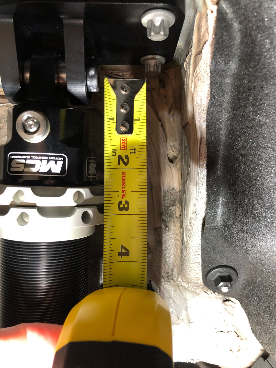

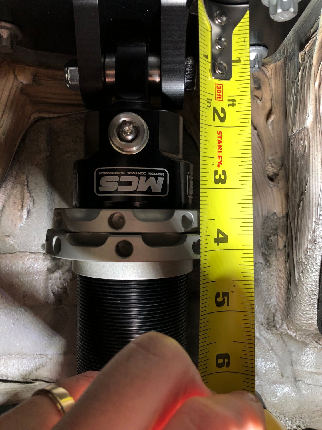

@Lumpy Sticks
Took some measurements. The sway bar is 8.5 inches from the shock tower mounting place at full droop.
Other measurements with photos, I could see the Feals clearing if they maximize space at the top.

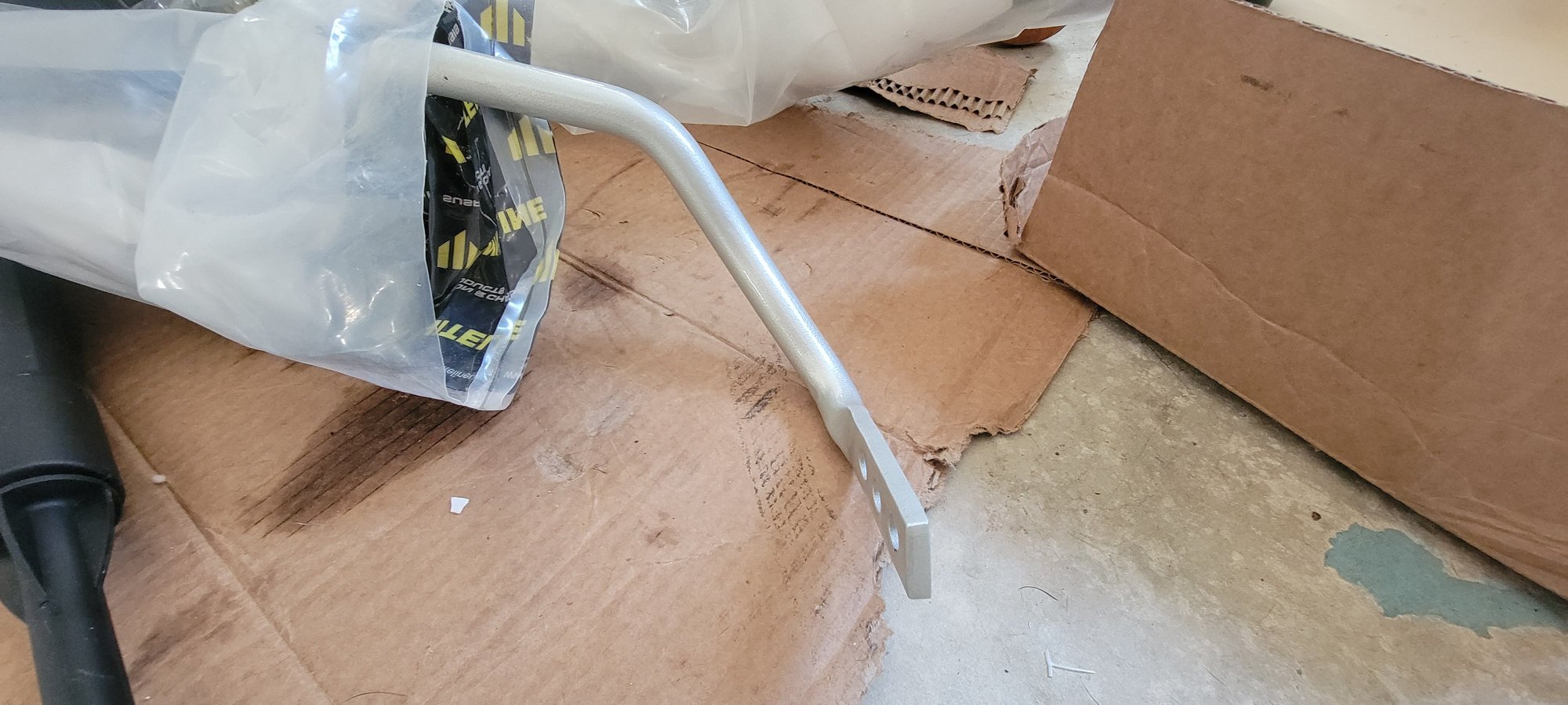

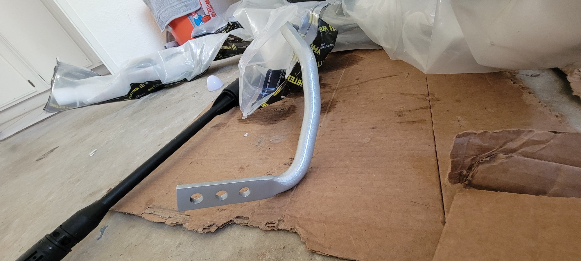

Thicker yes, by a hair. I see two things that may be in our favor. The flat spot from being adjustable and the shape looks flatter. Both will help clear the spring.
Either way, install is going to suck. This is going to be one of those things I do at work so I can borrow a lift and subframe jack.
