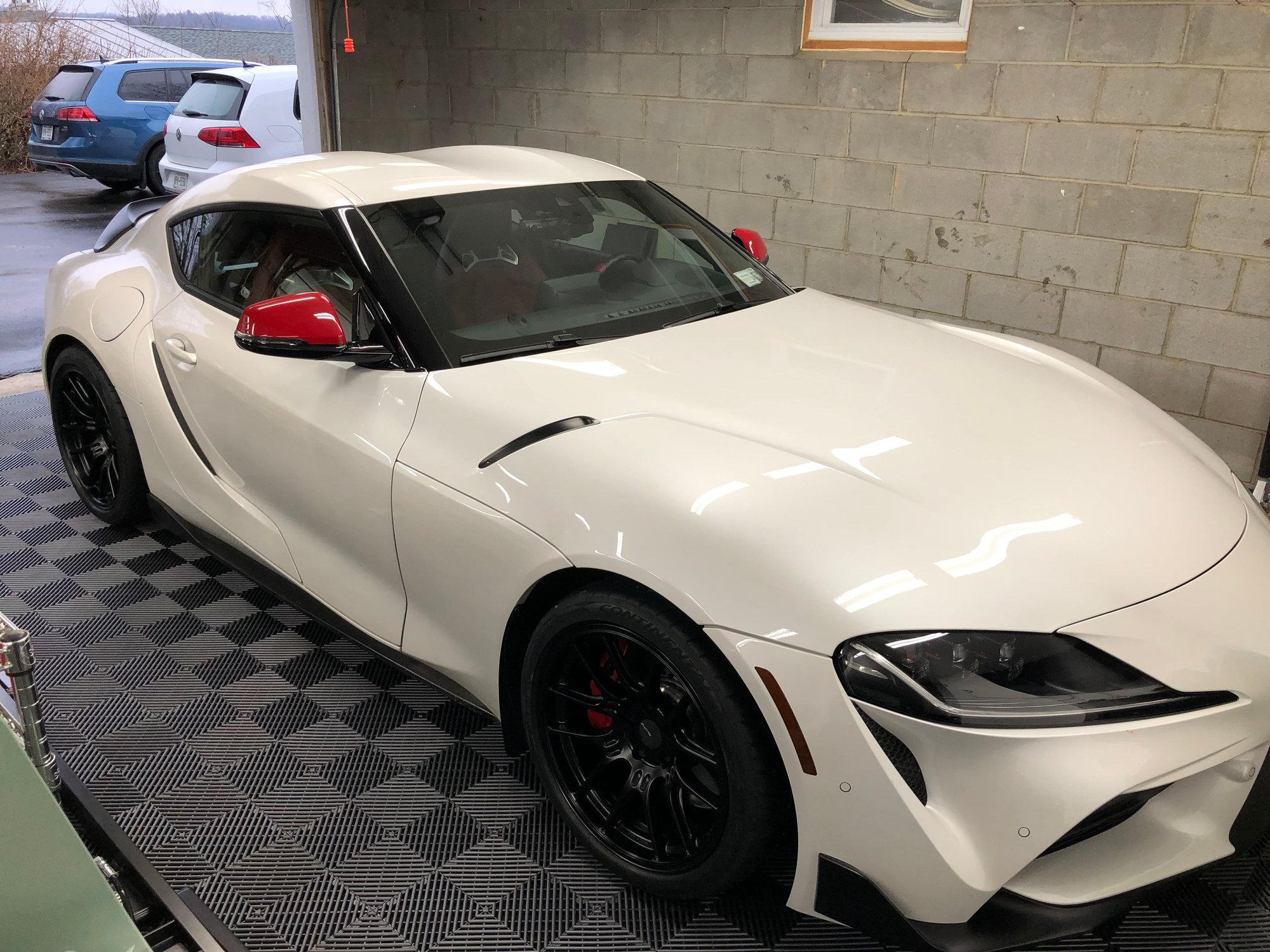

i mean about lowering and rolling the car back and forth. somehow i get away with paper under the front tires so I can turn the wheel without power steering. previously i use 2 sheets of roof flashing material when on the driveway(unfinished floor).
for the rears i have a left & right floor jack to lift and drop. I also just use 2 6" HF levels (just used as straight edge) and leave marks on my floor and also to square with the doors (instead of the bumpers). then nylon strings for squaring the fronts with rear tires. then 1 6" level + square rule for toes
Ah got it. Unfortunately, since it's an auto I cannot put it in neutral without turning the car on. Every time I lower the car, the car loads up until I turn it on, put it in neutral, then reverse, then forward.

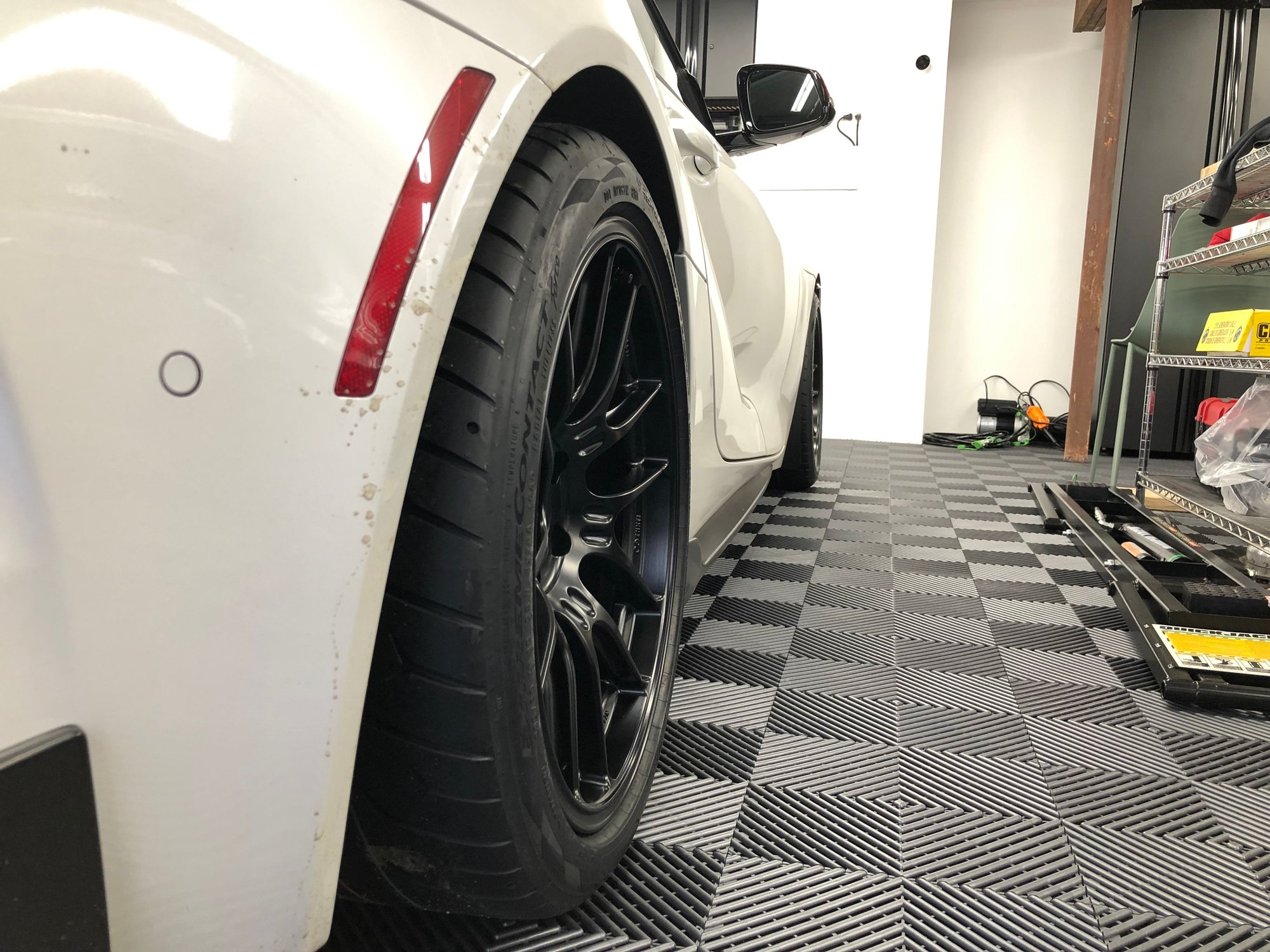

It was 66* here in NY today so I finally took the Supra out after installing the MCS coilovers, all the SPL suspension bits and giving it a proper alignment.
It feels FANTASTIC. All the nervousness, the weird way the chassis was upset by bumps in the middle of turns and the feeling the car wanted to kill me every time I got on the throttle are all now completely gone. I can now also feel much more what the chassis is doing, where before it was a bit more numb. There is still a little bit of a steering dead spot right off center but I've come to peace with the fact that is almost impossible to get away from with newer cars. I am still on the oem tires too. I bet it will feel even more amazing once i get the 295 wide 200TW tires on.
I ended up with 550/500 spring rates so it feels close to my evo now as far as ride quality. I would actually say it's a good bit smoother than the ohlins on my Evo, especially on bumpy pavement.

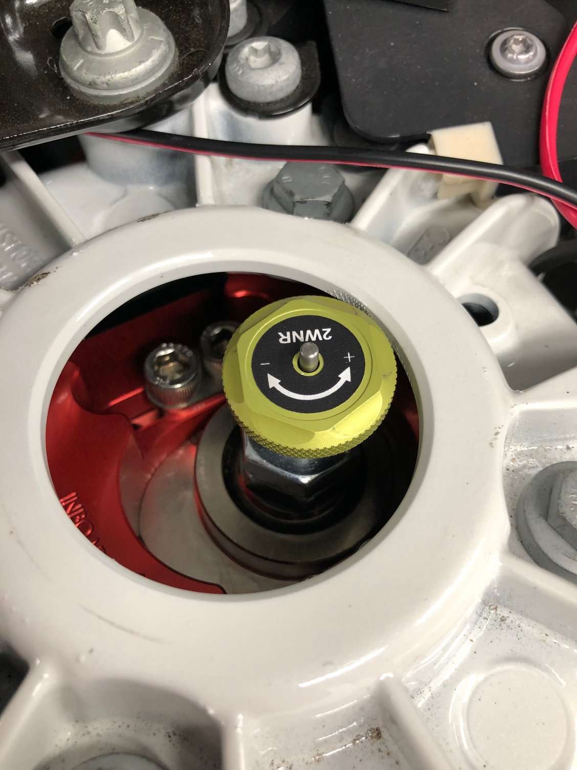

One issue is that I did a dumbass move and I guess I forgot to fully tighten the upper strut mount bolts on one side and when I dropped the car to the ground, the strut slightly shifted. Normally this wouldn't be an issue but with the way the strut towers are designed and how high the MCS adjuster is mounted, I had them very close to the strut openings to get as much negative camber as I could from the camber plates. Well, once the strut shifted slightly, the adjuster hit the strut opening and ended up bending the adjusting rod. I have an email out to MCS, I am hoping this will be an easy replacement.

Heard from MCS. Fixing the adjuster rod would mean taking the strut off the car and sending it back to them. Right around $300 for the repair, plus shipping.
I am going to run it how it is the first couple events to see how it feels. If I feel I need to adjust things, I am going to try and bend it back myself, if that doesn't work, I guess I am sending a strut back...

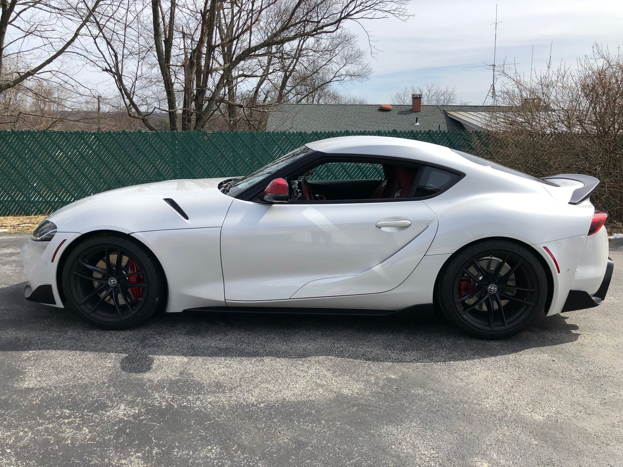

Put my track wheels on. Now the car doesn't look lowered at all. lol

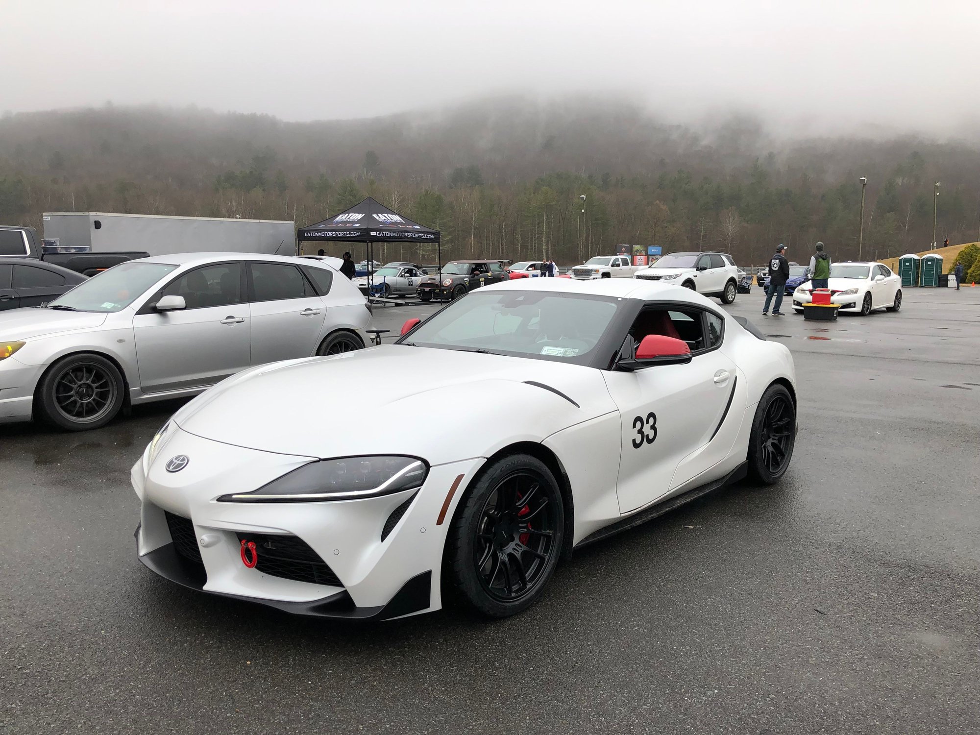

So, my first track day with the Supra is in the books, and oh boy what a day.
First off, the Supra in the cold and wet with 200TW tires, on a track I have never been on yet, is absolutely TERRIFYING! Also didn't help that I haven't been on track in almost four years.
Day started off in the 40's and by the end of the day it was maybe mid 50's. The first three sessions claimed four cars. I think two cars went into the armco or tire walls in the first session. Six cars crashed by the end of the day. Needless to say, I put my noob brain on and took it REALLY easy after continuing to see that destruction.
So yea, the Supra was super tail happy with the 200tw tires and wet and rainy sessions. I could barely give it more than 20% throttle if the steering wheel was anything off center. Most of the day the tires where max 70F and by the end of the day as it started "warming" up I was able to just get 100F in the tires, which is probably still not even close to what they need. A bunch of people brought all season tires. Welcome to the East Coast I guess. The AWD and FWD cars with all-seasons where by far the fastest, which made sense. The good news is I was able to learn the car and track at much lower speeds than if it was a dry warm day. Lime Rock is much more fun than I had anticipated, and deceptively challenging.
In the last session I knew the track a bit better and was able to start going a little faster. There is absolutely a ton of potential in the car and I can't wait for a warmer dry track day. I also need to get my Sparco seat, harness and hans in the car. I am sore today from trying to keep myself in the seat, and I wasn't even fighting huge G-forces yet.
