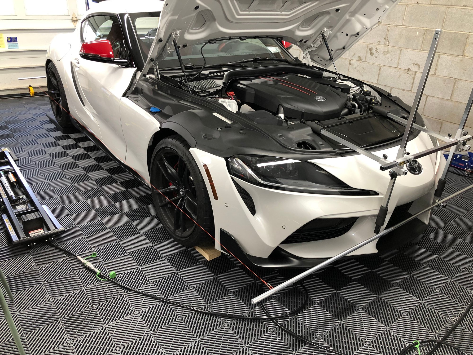

Slowing getting the Supra ready for track season.
While doing some research on good alignment shops, I found out there are none very close to my new place of residence. I then decided to finally invest in a good string alignment setup.
This was surprisingly pretty easy to setup and use. The most tedious part is lowering the car down, driving it back and then forward to settle the suspension and then take measurements again. Luckily this setup is mounted on the car so you don’t have to reset it every time.
This is also the first car I have owned that had jack points so low. Even with my very modest .5” lower set height, I can’t get my quickjacks under the car without driving the car up some ramps and wooden blocks.
So, now I have the coilovers fully installed with SPL rear toe bars, rear traction bars, front lower camber arms and bumpsteer bits, and the ride height and alignment all done. I have a track event next Friday. Looks like the weather should be mid to high fifties. Currently showing rain so crossing my fingers that changes.

I just put paper under the front tires (on vinyl tiles) and do lock to lock turns. for the rears I just jack up the control arms just a hair above the floor. wont that work too?
Not sure what you are referring to?

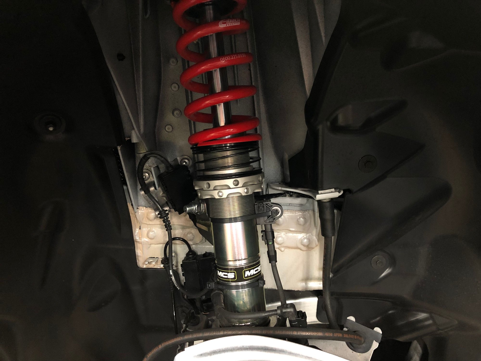

MCS photos. These better blow my mind because they cost a fortune and I had to change a bunch of things because Vorshlag is the worst.
Who makes your string kit? I've driven myself crazy trying to do strings without them mounted on the car. That looks so much better.
Worst headache ever and not worth the $avings. ON the car would be pretty sweet.
https://www.summitracing.com/parts/BGR-BGR200
Crazy, the price increased $200 from when I purchased it a couple weeks ago!

Same but cheaper?
https://www.murraymotorsport.com/b-g...xoCWNEQAvD_BwE
i mean about lowering and rolling the car back and forth. somehow i get away with paper under the front tires so I can turn the wheel without power steering. previously i use 2 sheets of roof flashing material when on the driveway(unfinished floor).
for the rears i have a left & right floor jack to lift and drop. I also just use 2 6" HF levels (just used as straight edge) and leave marks on my floor and also to square with the doors (instead of the bumpers). then nylon strings for squaring the fronts with rear tires. then 1 6" level + square rule for toes
Old Mar 12, 2022 | 04:29 PM
