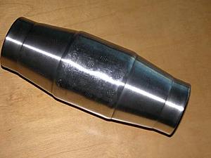

Originally Posted by JT-KGY
Rick,
Have you look at the 3" hiflow cat from Random?
How does that compare to yours?
Thanks,
Jack T.
Hi Jack,
You finally going to mod that thing?
Compared to the Random cat there are 3 advantages:
- Less abrupt transition to and from the center core.
- 100 cell vs Random's 300 cell.
- Less cost.
5 of the STU national trophy winner's cars have one or are on hold for it, and that's not counting STX.
Let me know and I can bring one up for you next Sunday. Also looking at a bolt-in solution.
