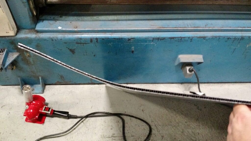

The resource of me knowing how to apply alumilite in some fashion other than a front splitter. LOL
Or to add widebody parts.
Etc
Etc.
My budget is super modest, so I'm happy with my car so far, but I'd really like to do more.
Using a block of wood or a round tube pressed against the alumalite and slowly pulling up will create the shape you desire..
i'll have to check into that.

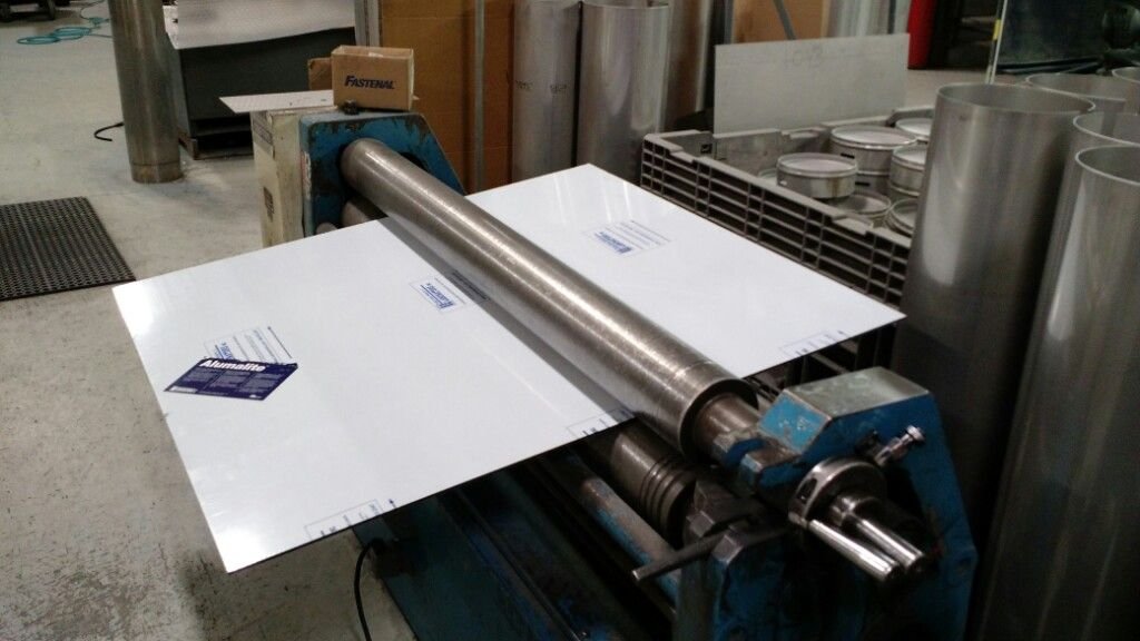

or if you have a friend with a sheet metal roller
