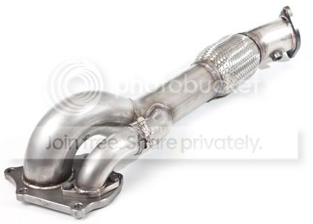

Originally Posted by BluEvo210
I have one of these:
(ATP "divorced and transformable" downpipe)
After 8 years and 80,000 miles it has a leak in the flex section. I think I got my money's worth out of it.
I might just replace it with another pipe of the same kind.
