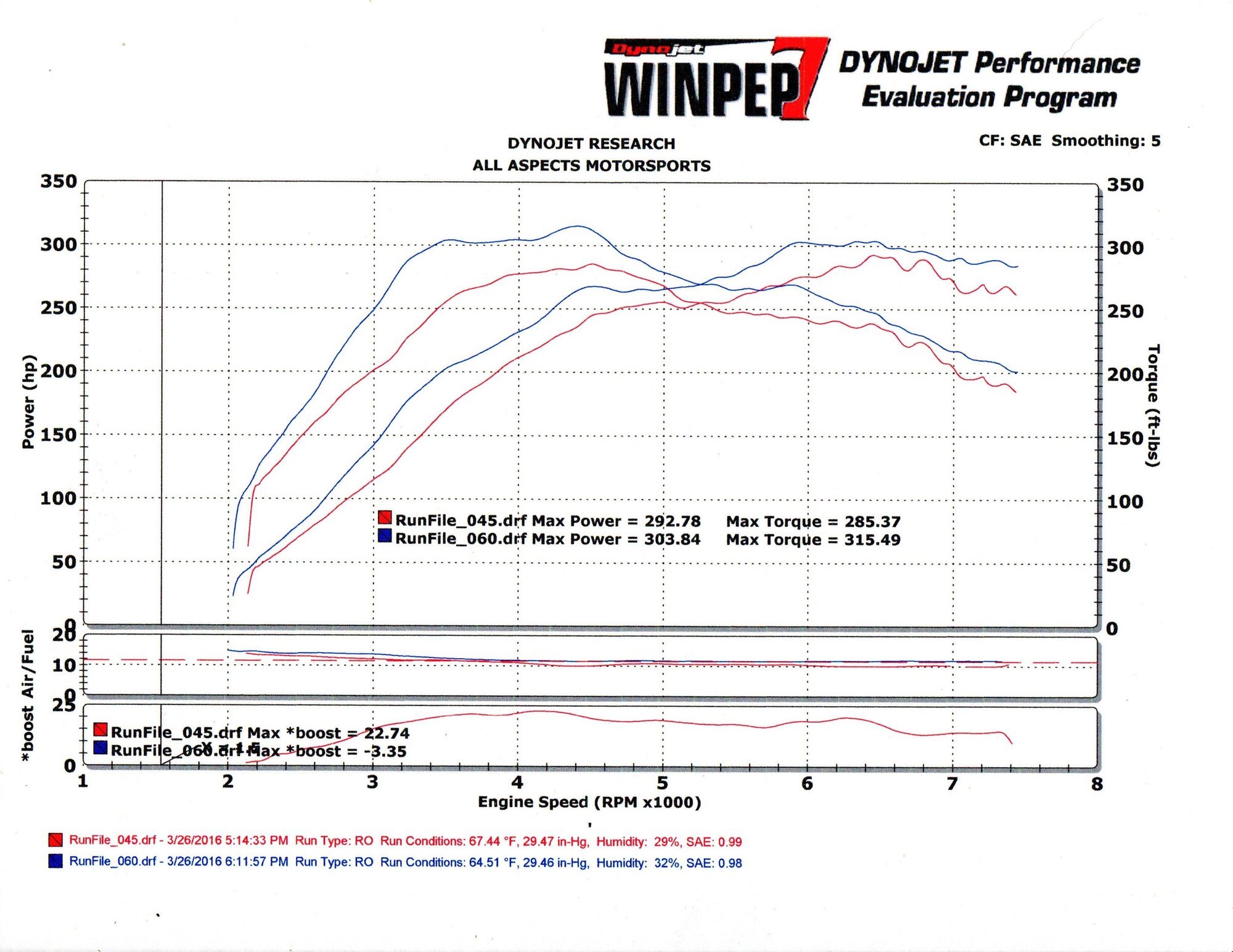

Chris Carbee was at All Aspects Motorsports today, and he tuned my car.
Baseline power was 292hp on a DynoJet. I don't know what that translates to at the flywheel. I was back to stock software, and hardware hasn't changed since the sketchy dyno test in 2011.
Originally Posted by BluEvo210
I have a K&N panel filter, which I don't even count as a modification.
Mods are an ATP "divorced and transformable" 3-inch downpipe, and a twin-tailpipe exhaust installed by a local muffler shop.
Compared to the stock downpipe, the new one has a bend radius about twice as large. This was the first mod on the car, and I immediately noticed an improvement in throttle response.
After the stock catalyst, the exhaust has a 3" pipe, and a Dynomax "Race Bullet" muffler. Shortly after that muffler, there's a Y-pipe that splits the exhaust into a pair of 2" pipes. Each pipe has a Magnaflow muffler with a 2" core.
The two 2" pipes have a combined cross section slightly smaller than the single 3" pipe. I thought that would help the torque and throttle response.
The 3" pipe has a cross section of 7.07 square inches, and the 2" pipes have a combined cross section of 6.28 square inches. The law of "Conservation of Mass", as it applies to fluid mechanics, dictates that the exhaust will have a higher velocity in the section with the smaller cross section. Higher velocity means it has less pressure relative to the 3" section, so that might help pull the flow through the pipe.
Chris did dyno runs from 2000rpm, just like I wanted, and didn't question the STU rules. I told him "stock boost map" and he rolled with it.
Chris got me 303hp and 315 ft-lbs at the wheels on the Dynojet. The final power curve is higher throughout the entire RPM range.
Unlike stock, and the previous tune, the new tune has much better part-throttle response.
EDIT: I also think heel-and-toe downshifts are easier, because there's less throttle lag and less throttle hang.
Previously, when I floored it at 2000rpm or so, the boost would kinda sneak up. There was this feeling of "The boost came on... When did that happen?"
Now if I floor it at 2000rpm, the boost comes on with a noticeable kick.
I like it. I can't wait to scare some passengers.

More tq than hp? I don't think I have ever seen that on an STU car, but I've never seen any X plots.

24-25psi is not stock boost...lol
Where are you seeing that?
The scale I see with a "25" on it, the graph never makes it to the 25.
If that's my boost graph, it looks fine to me. Stock is somewhere around 21.5psi.
EDIT: http://www.socalevo.net/threads/1955...Psi-in-a-Evo-X
So, it's targeting ~ 22 psi at the peak. (Peaks at 1.5 bar, tapers off to 1 bar.)
And a modified car with stock boost map can go as high as 26psi if the boost spikes.
And we can expect a certain amount of error due to the 2 solenoids fighting each other.
After reading all that, I believe my 22.74psi is pretty damn exact for stock boost map and controls.
Neither have I.
It looked close to 25. Graph says max boost was 22.75. I guess it could hit that with the reduced back pressure from full exhaust.
