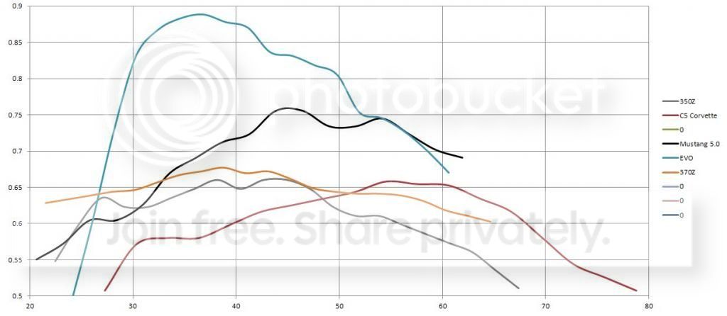

Originally Posted by griceiv
I still don't understand why there is so much effort being put into making a car that clearly no body cares about for autox (C5 non-z06) competitive. AStock is a total flop, so now they're going to kill STU with it? Other than at a pro launch, I can't see a single aspect of an evo that can keep up with a vette on larger tires. The only course dependency I see is by how much the c5 beats you guys by. on a slower course you might be close. On any course where you hit the rev limiter in 2nd will get killed.
The justifications for this move, at least in Fastrack, have been so bogus that I actually hope there really are a wave of letters supporting it.
* Class in decline... slightly, but not compared to STC / STS, which fell off a cliff this year.
* Dual purpose cars: yeah, the Vette is a great dual purpose car, unless you need to carry more than two people, or you live in a climate where there is some sort of weather other than sun. Oh yeah, if dual purpose cars matter, why do STC / STS exist? Do people typically drive to work and haul their kids around in 25 year old Hondas?
* More diverse class: An E36 M3 won last year. It's not anyone's fault but theirs that no one runs one as it has clearly proved it cam be competitive.
Question for the audience - is there another ST* class that will have a BIGGER course dependency than ours now? Maybe STX, but even then I think they are a lot more similar in size and shape overall than STU.
I feel like there was no amount of feedback that was going to change this. Someone posted this on another forum:
I mean, if I was going to pick something to dig out of a 25 mph corner on that chart, who WOULDN'T pick the 2.0L with the big laggy turbo?

Butt Dyno- is that graph Gs vs. MPH?
Is there any other info about it? Tire sizes/ compound/ brand/ surface/ temp/ same day/ same driver?
I would love to have some Corvettes in STU but maybe the C4 is a better fit; or limit them to 245s
Wow
We never saw anywhere close to that kind of lon-G on the BSP (ASP) car. And that was with WAY more TQ than I ever saw in STU. Whoever made that graph either knows how to skew the info or just made a mistake.
Corey

Originally Posted by CoreyR
Wow
"David_SS" (Whitener)
here's the photostream that graph came from
http://s256.photobucket.com/user/Dav...id_SS/library/

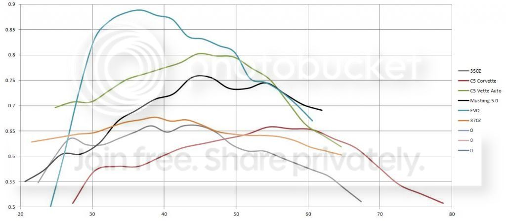

...and look at the chart that includes the Auto C5, lol
is he on the STAC?
it would appear that he is (Aug 22, 2012)
and that he either owns a C5, or would like to (based on his photostream)
so......
begs the question, are we sure we're being represented properly/fairly?
at a minimum I'd like to see the math/science behind that chart, and how much/little it weighed in their decision
We are not represented. I don't think that there's anyone on the STAC that currently competes in STU. And since that STAC is volunteers (on a space available basis), that's our fault.
And while I should have written my letter sooner.. apparently, I would have liked more than one fastrack cycle for this decision to have been made.
-'chono'
...and look at the chart that includes the Auto C5, lol[/IMG]
Did we really create a class where the pinnacle of the class, the car to have, is a 12 year old automatic corvette?

Looks like David_SS owns or plans to own a Grey C5 Corvette:
Also: http://s256.photobucket.com/user/Dav...tml?sort=3&o=8
It's also a little suspicious that he made two versions of that chart. The first one (photobucket shows newest photos first in the stream as far as I can tell) included the C5 Auto, but he later uploaded a second version of the chart with the C5 Auto curve removed. Not to mention the bizarrely unrealistic values for the Evo in there.
I really hope that chart didn't weigh into anyone's calculations.
Wow
Corey
That's what I said on rrax forums when that pic got posted. someone screwed the pooch making that graph.
