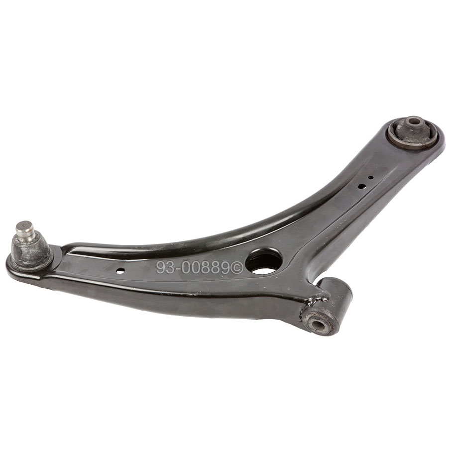

Anybody know if the x and the ralliart use the same lca?

From: Kentucky
Nope. RA is stamped steel and different geometry.

I'm 90% sure what I was seeing was not stamped steel. They looked like 8/9/x arms but slightly thicker, I assumed the stamped steel ones don't look remotely equivalent.
I'm 100% sure they are steel. They are not forged aluminum like the Evo.
