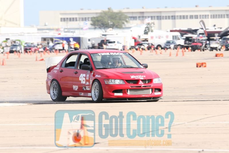

Splitters are legal in SP as long as they don't protrude farther than the farthest point of the bumper. That lip, however would not be legal. Something like the Millers have would:
You can remove the rear wiper because the RS doesn't have one. Update/Backdate. It's iffy as to whether you'd have to replace the rear glass with RS glass, though. Honestly, I'd just put a plug in the hole. Wash tank still has to stay.

So....spring rates are something that Dallas, Marshall, and I may disagree on, but generally speaking I like to run higher rates in the rear. This is the part where Dallas will disagree: 800/800 may be a little soft on race tires, especially on the heavier X. I think the X I drove in 2011 had 800/1000 rates, and you can see the roll in the pics I posted.

But you attached action pic so you win
