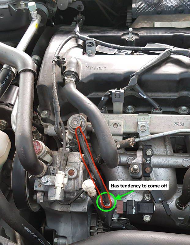

Originally Posted by kyoo
yea that is basically what RS described. i didnt even know it was a thing but yea i guess it's bypassed now.
I'm assuming the solenoid is bypassed and now you are running a pressure signal directly to the FPR. The Evo X there is no silly solenoid so it's a direct pressure source to FPR connection.
Make sure the hoses are securely zip tied!
Evo X is like this:

I don't know what mitsu bean counters were smoking, but some of those barbs don't even have nipples, let alone clamps on the hose. Zip Tie all the things!

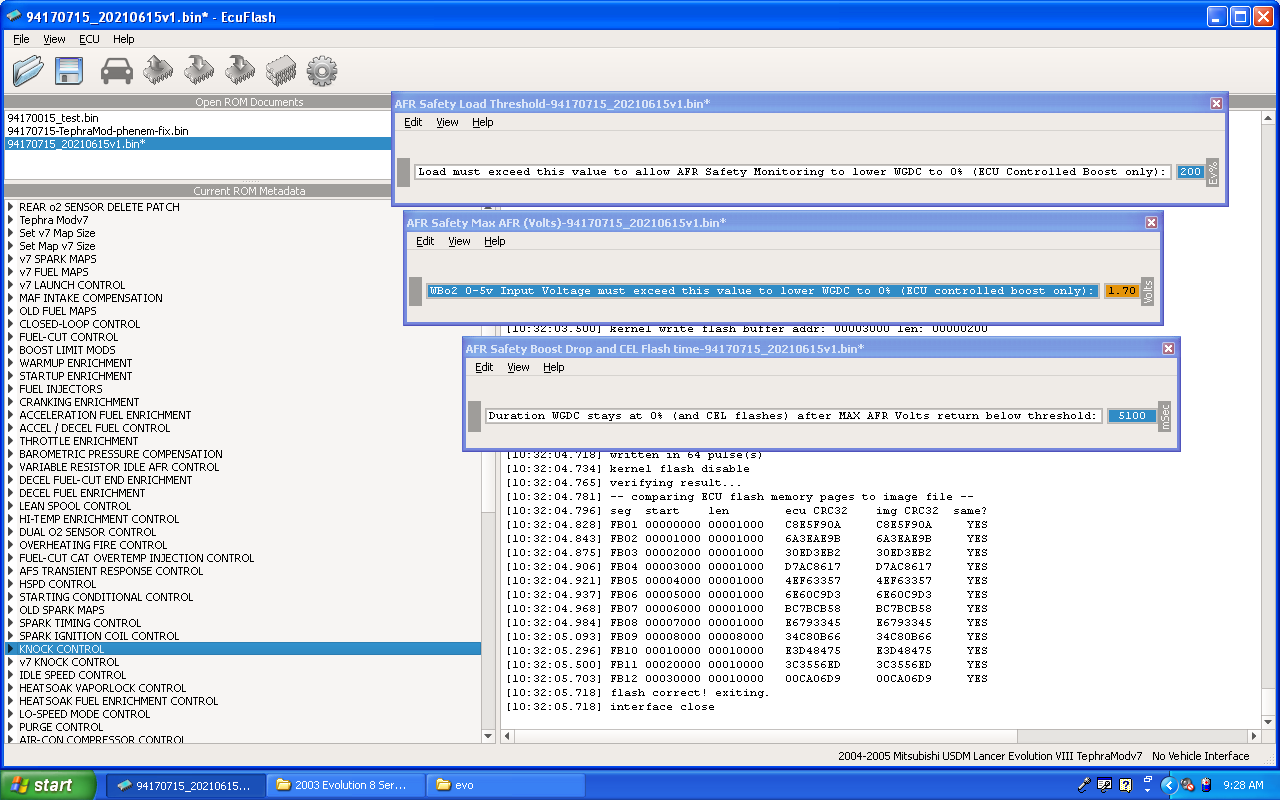

Here are those settings I was talking about. They will be different based on your setup/preferences so nobody copy/paste

So, on the 8s and 9s, people are bypassing the solenoid and compensating in the tune to deliver a longer start up pulsewidth? I've never heard of that. I have heard of the vacuum line sliding off the FPR. That happened to tons of people when these cars came out because it was common to tee into that line when installing a boost gauge, and a lot of people just reinstalled a random vacuum hose without a zip tie. I've always been meticulous about the secureness of the connection to the FPR, but didn't even think about the other end of it.

Worth a followup convo. The way I setup mine was to flash the cel longer for a wideband event so I can easily tell the difference between a high knock and a high AFR by how long the cel flashes. They behave differently, knock pulling timing and AFR out of range pulling boost. Enough knock will probably throw down your octane number and pull boost too, but if your WG spring is high enough or you aren't full boosting you might not even notice the boost cut so having the cel behave differently is helpful.

My car has had the FPR reference line ran directly to the manifold since I bought it and have never had an issue. Delete the solenoid.
