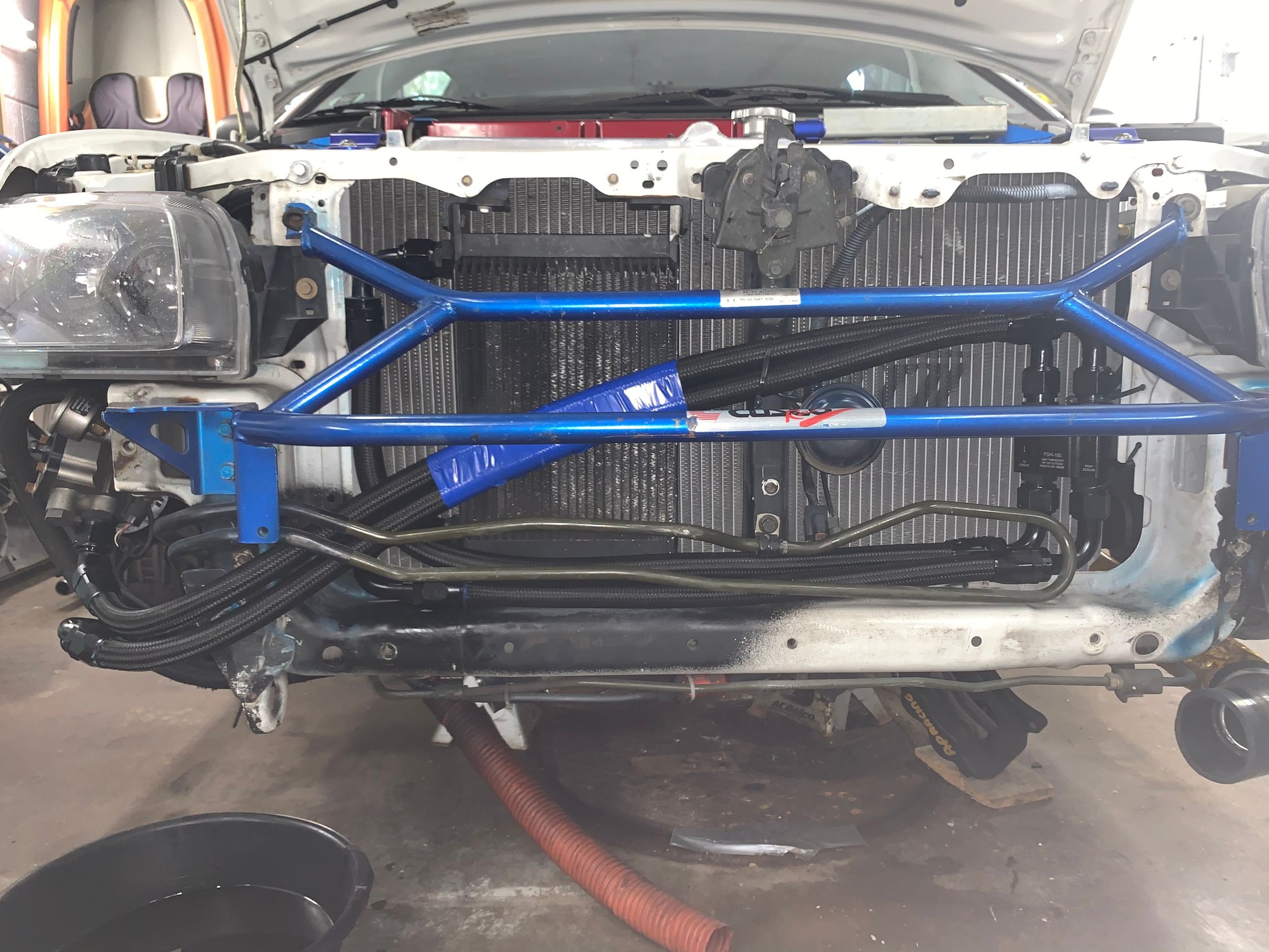

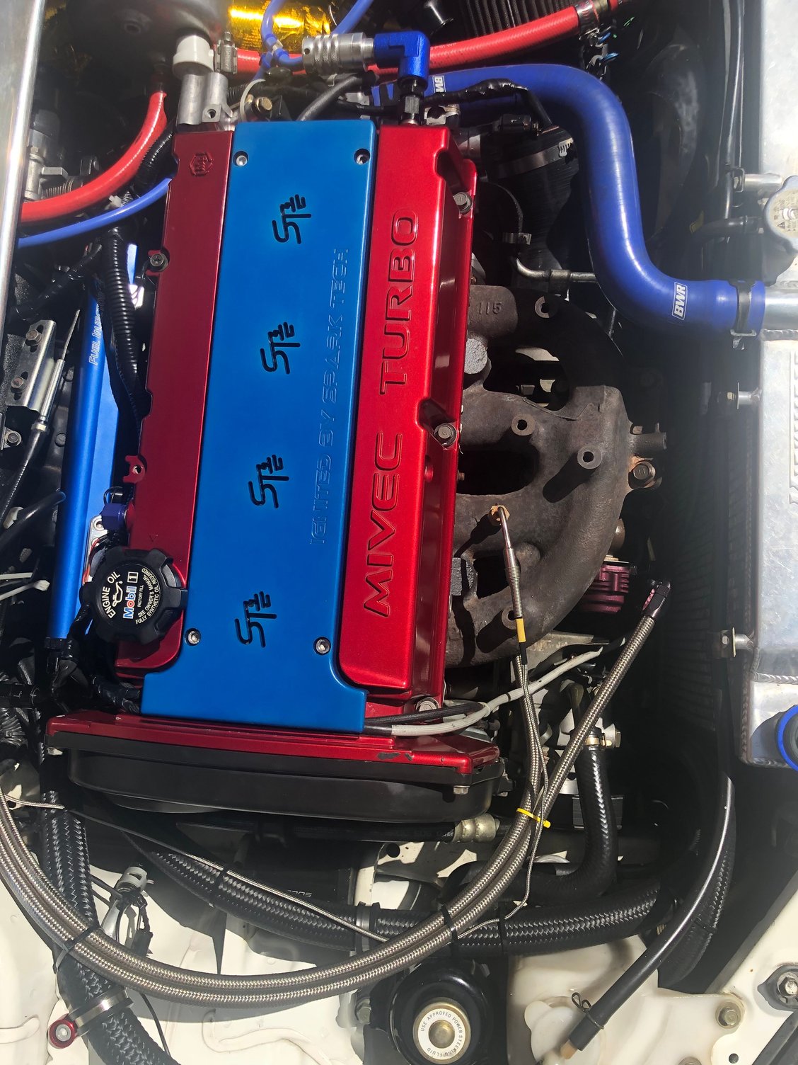

Balrok, Here are a couple pics per your placement questions. Can’t find pic of oil thermostat plumbing. Frosty?

Thermostat plumbing to Setrab oil cooler/Sump system.

Cool thx. Interesting, goes to show though - his downpipe is all exposed right next to all of the oil parts, yet the oil barely gets up to temp since it's always in flight. But what he mentioned earlier, all in all how much more weight did it all add assuming you knew the weight before?
Is this an oil feed line to the top of the turbo, going to a pressure side of the pump?

Idk. Call magnus and ask them what the shipping weight is on their dry sunp kit. Then add 12QT oil.
and yes it’s an oil feed.

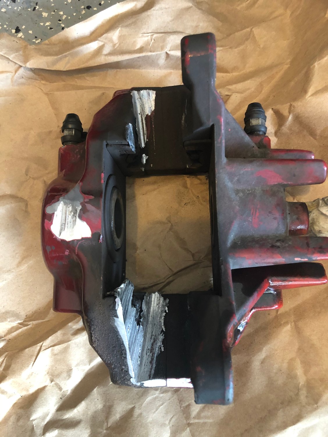

Melted rotor to rear caliper
Yuck! Still haven’t sourced good rear replacement calipers.
I have a spare rear set I can part with I suppose. I’m located in SoCal and leaving to the northeast for the next couple of months so let me know before I take off if you want them.
