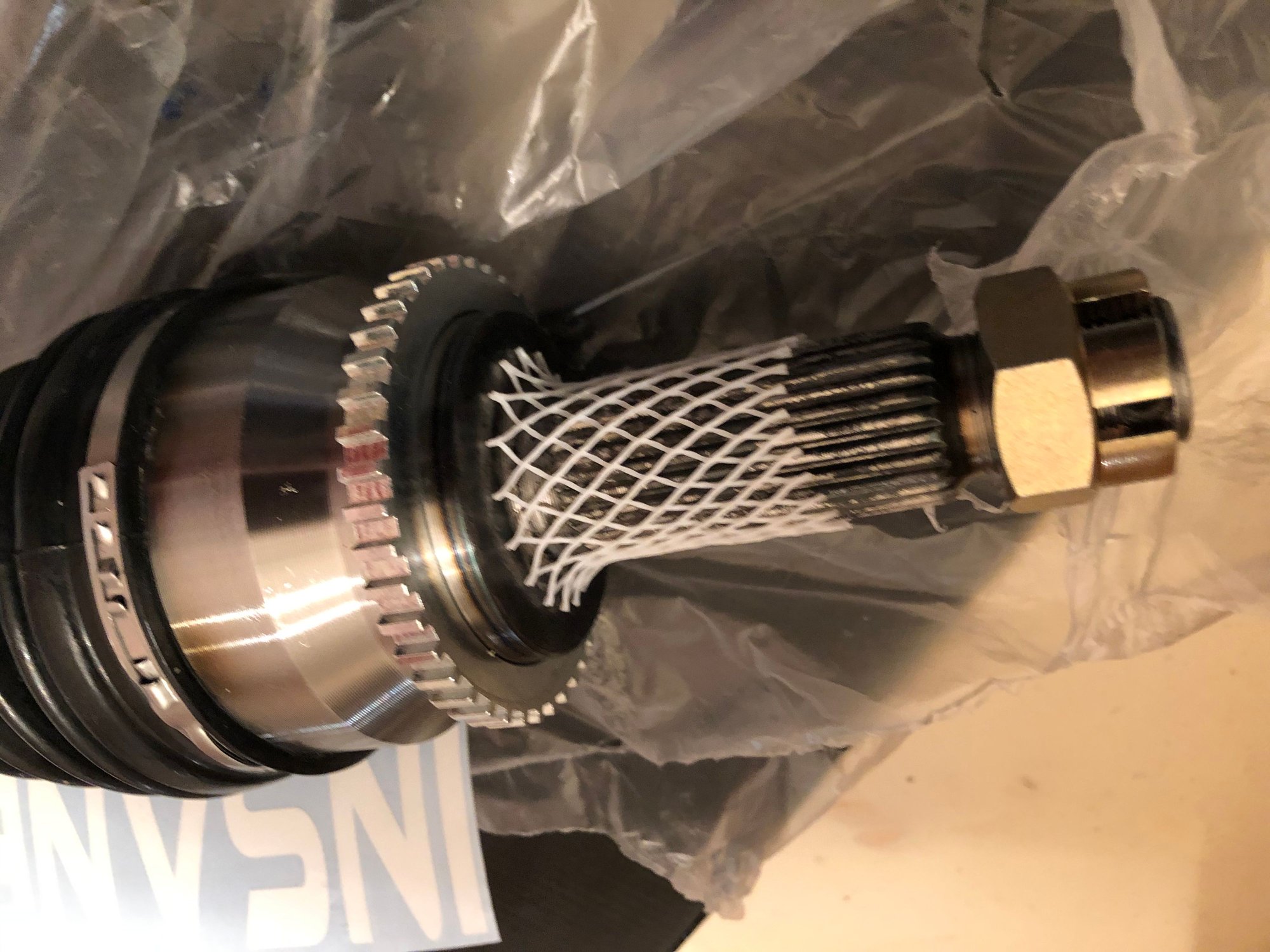

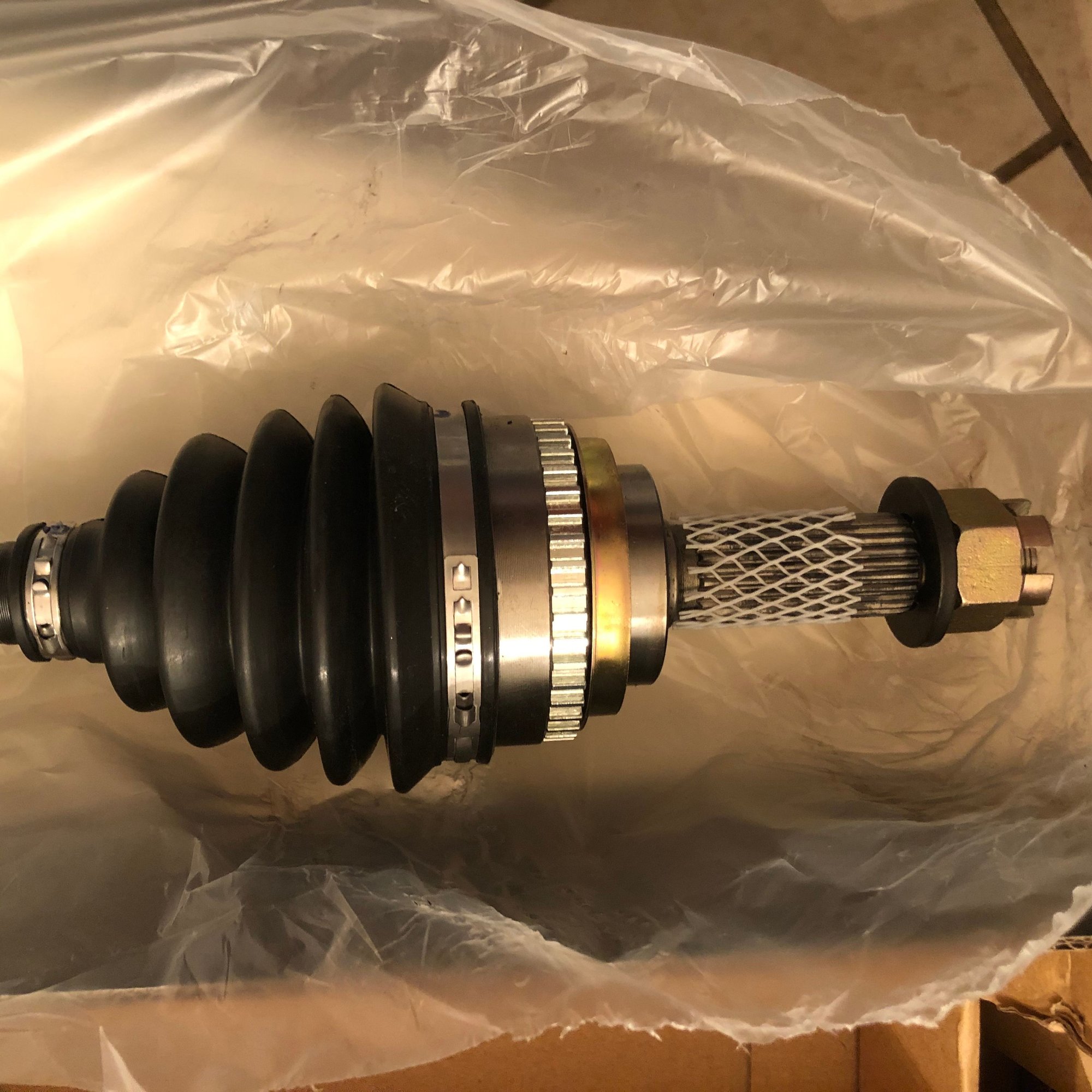

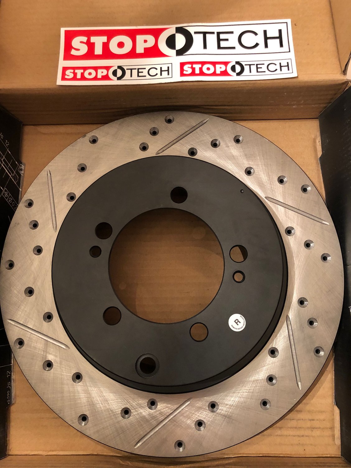

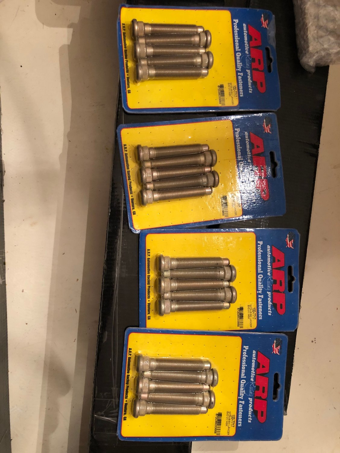

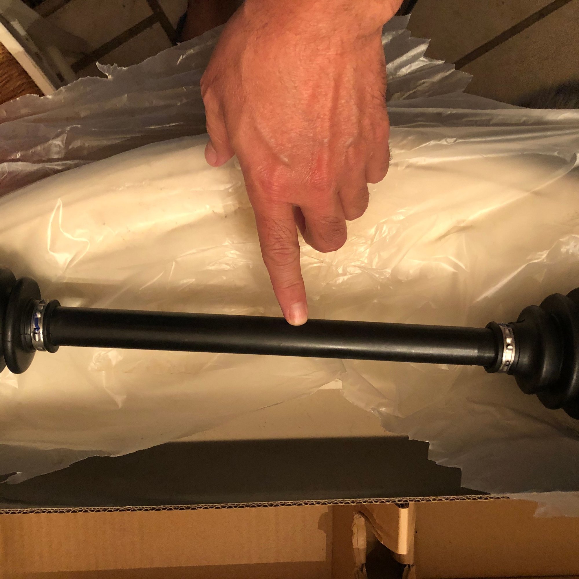

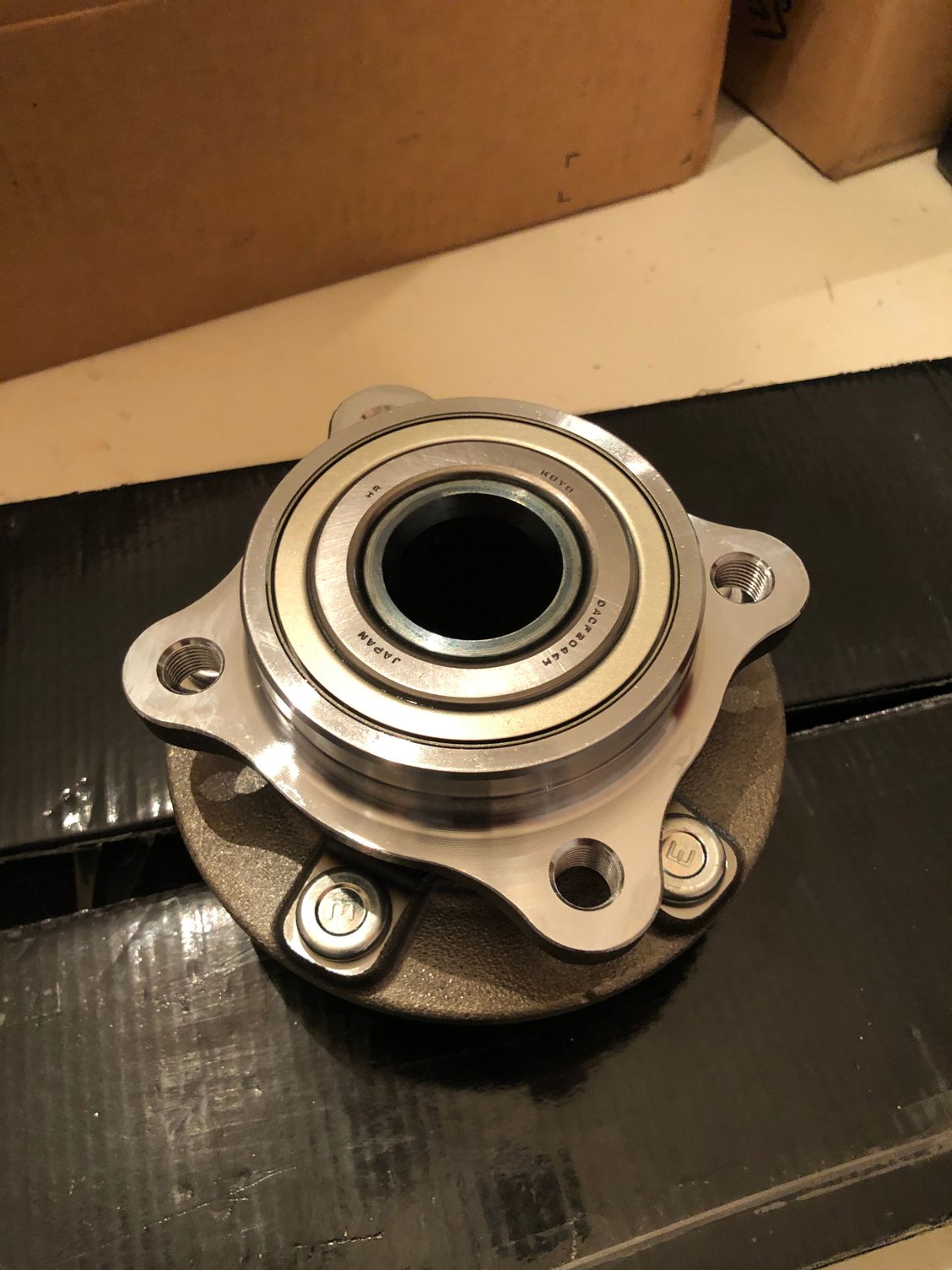

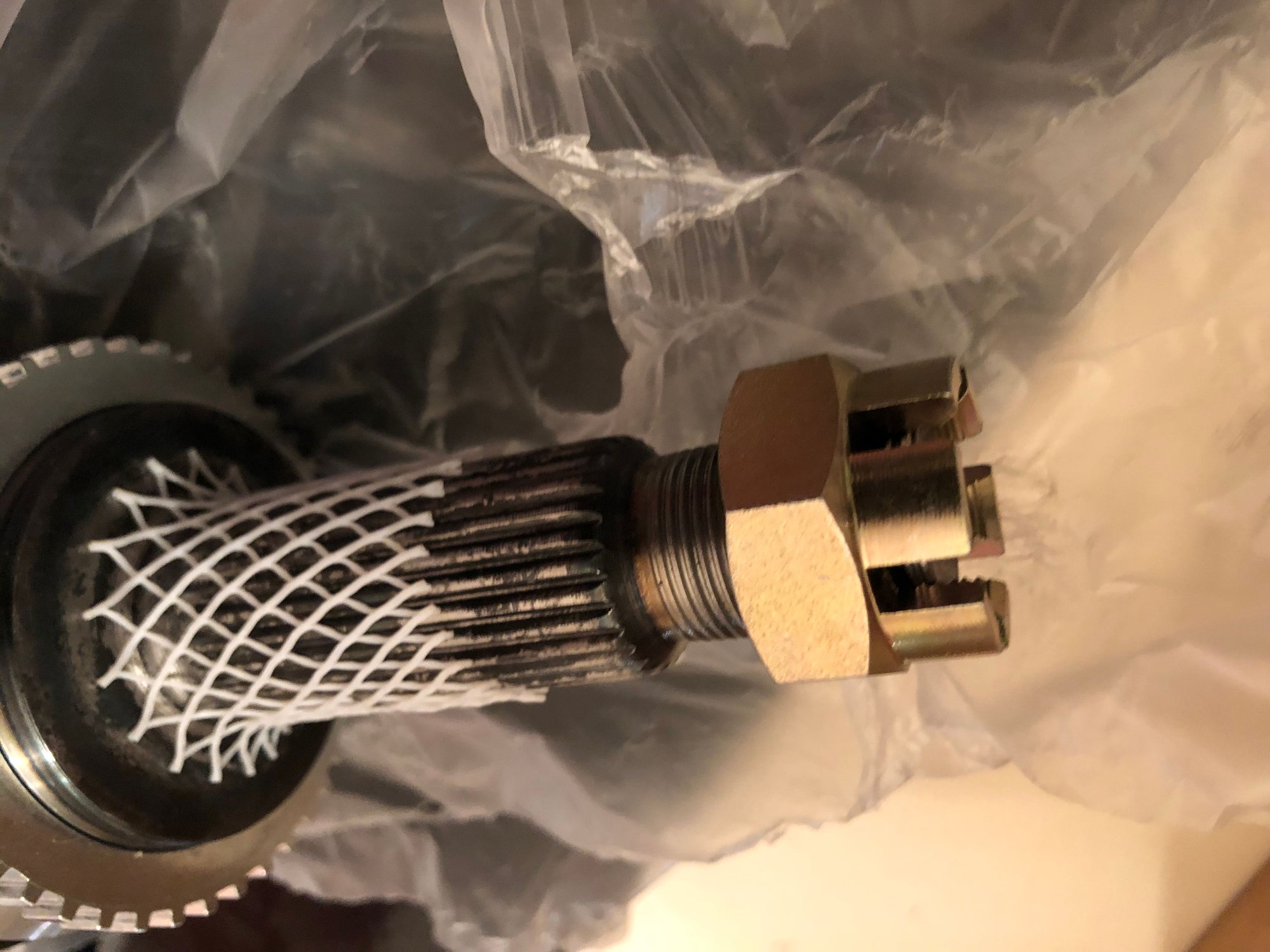

Insane Shafts front & rear = beefy!
OEM HUB Assemblies
Rear brake rotors
Replacement ARP Extended Studs

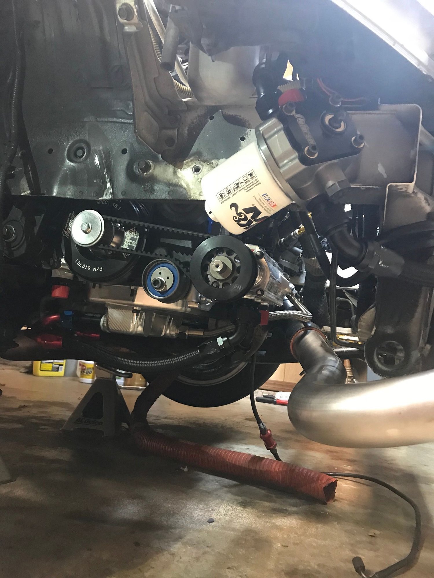

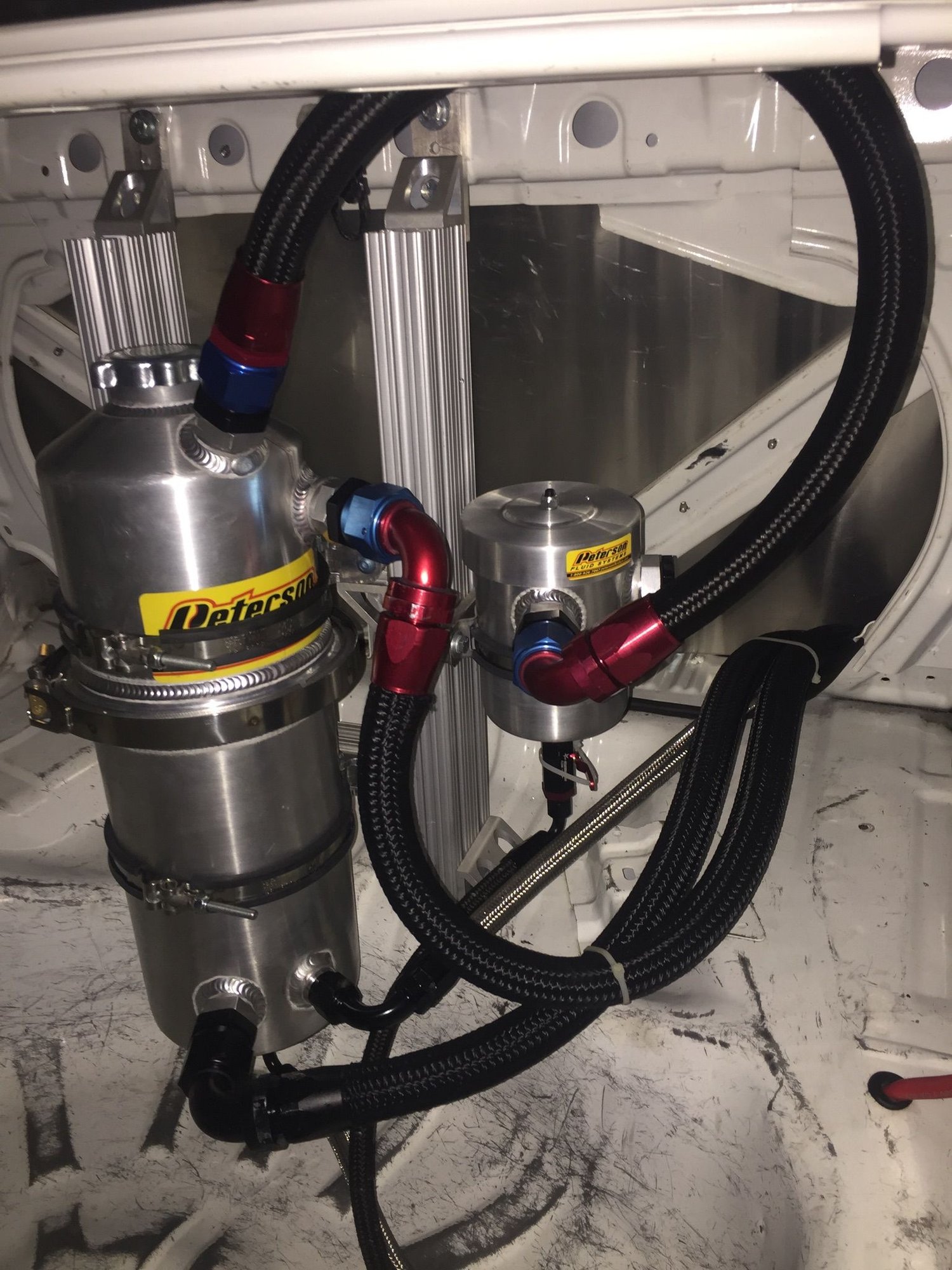

To dry sump or not to dry sump.....that is the question....
Pro's:
Best oiling setup possible, more engine life
Constant VAC to eliminate a host of issues, more engine life
Con's
Living with a dry sump,
priming
oil changes
filter changes
oil over cooling
Do the oil changes add up to more then the replacement engine lol.
sheer complexity and cost.
Sigh.
Old Jul 14, 2020 | 11:03 PM
  #71
Driv200's Avatar
Joined: Mar 2005
Posts: 739
Likes: 55
From: Oklahoma
I’m biased. Just do it! When you mention longevity, cooling, constant pressures, and vac issues resolved in the same sentence.....that’s your answer. Peace of mind on track allows for more focused driving. With a remote reservoir, it’s easy to drill/crank between those long rest periods. Easy! I use a canton racing stainless oil filter (not shown in pic). Always bought a case of oil anyway. Now, it just uses most of it. About 10quarts. Had to put a oil thermostat on b/c car ran so cool. Those late nights or during Fall/winter months, car never got to temp. Ha!

What's the approximate weight penalty of a full dry sump setup? That's almost 40lbs of extra fluid alone. That extra oil, the pump setup, tank, and lines to the trunk start to add up. 80lbs? 100lbs?
Old Jul 15, 2020 | 08:55 AM
  #73
alpinaturbo's Avatar
Joined: Mar 2007
Posts: 795
Likes: 54
From: California
Driv200 - do you vent your valve cover to the dry sump tank, or use the separate vacuum-pump to setup vacuum on the motor?
Is the valve-cover vacuum system/ventilation at all connected to the drysump tank?
Thank you.
Old Jul 15, 2020 | 09:54 AM
  #74
frostEvo's Avatar
Joined: Jul 2017
Posts: 13
From: Oklahoma
Thank you.
Vacuum relief valve on the cover. All goes to oil pan
Old Jul 15, 2020 | 10:08 AM
  #75
LetsGetThisDone's Avatar
Joined: Oct 2013
Posts: 15,973
Likes: 1,629
A small penalty to pay for engine piece of mind. And it's weight you can put mostly in the rear. Especially since the engine no longer holds 7qts (like a big wet sump).
