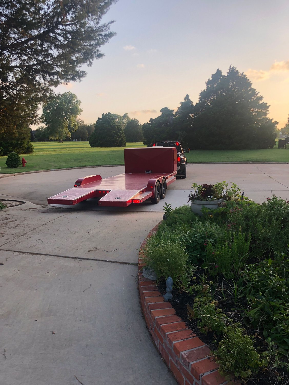

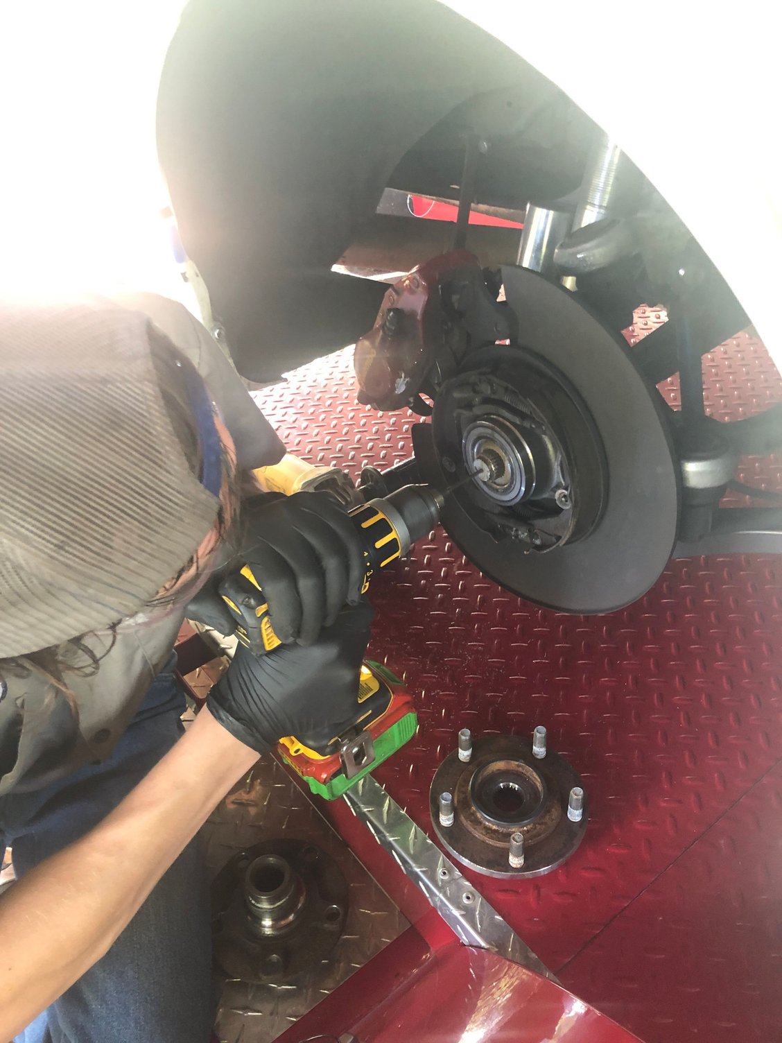

Got it off the trailer just now! Tapped the axle end, bolted hub back on over splines. Held breath getting it from trailer to garage. Whew!
